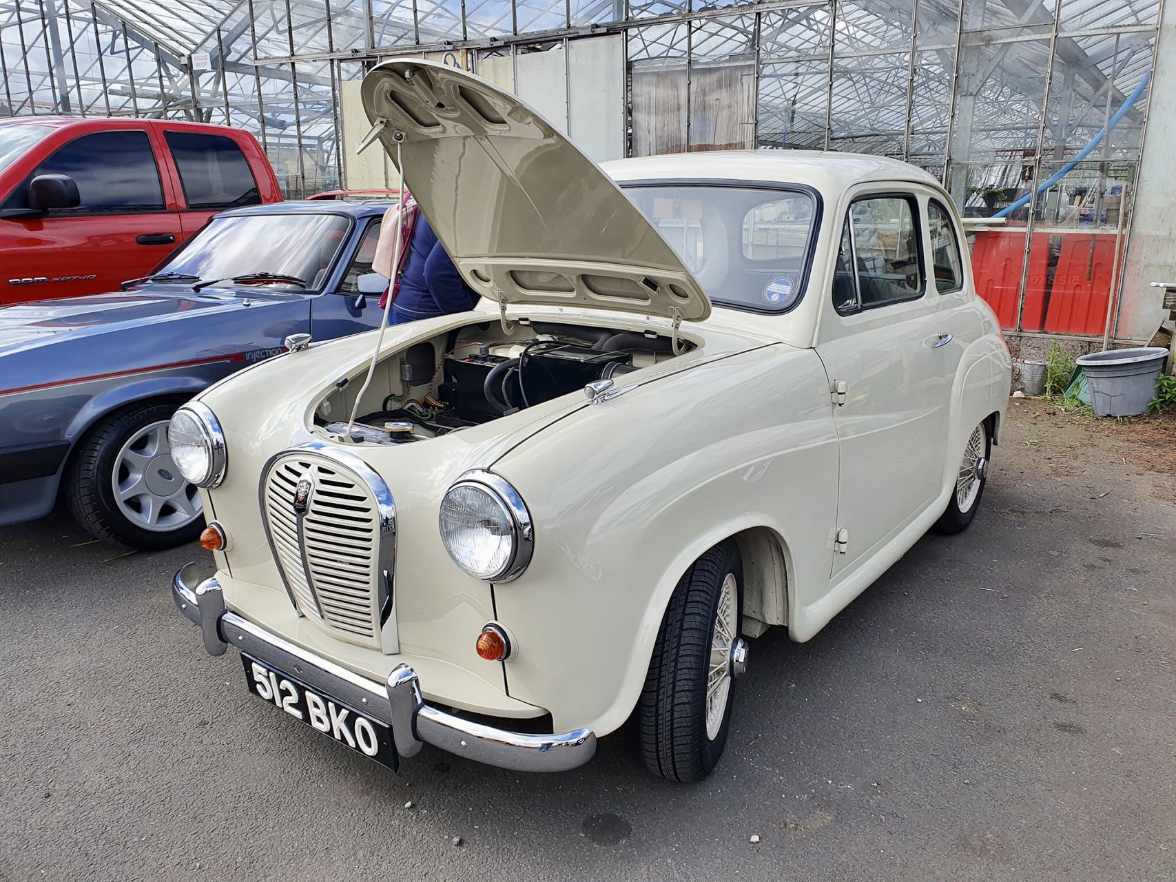

This was a lock down build, I brought the car home the day of the 1st lockdown, March 2020.
I wondered if I was being a bit reckless, taking on a new project when maybe I wouldn't have any work for a month or 2.......so I thought.
It turned out we were on UC for 2 years, but the good thing was that I
Attachment 59435
had plenty of garage time, and the lack of funds simply added another layer of challenge to the project.
The full story of the build is on RnS.
https://www.rodsnsods.co.uk/threads/....552615/unread
I always felt that you couldn't have a hotrod without a V8, but I've actually really enjoyed the Ruby, it's enormous fun in a tiny package, and the stock MGB lump is good for 100 mph, ahem, allegedly, Officer. And is great on economy so I can afford to drive it anywhere and everywhere.

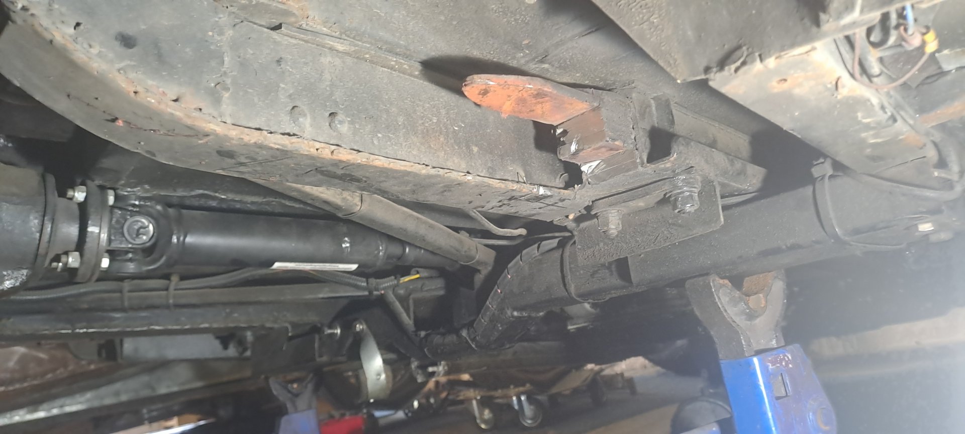

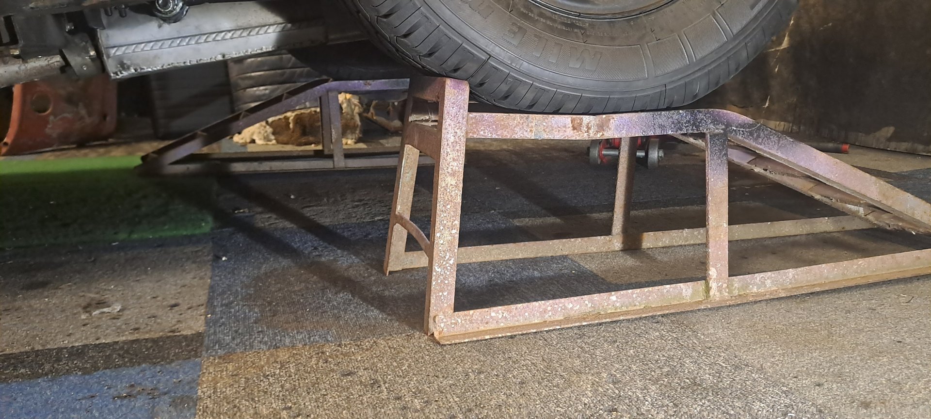

One thing I wasn't happy with though was the rear suspension. When you drive over a bump with the front wheels it's fine, but when the back wheels go over the same bump it's vicious.
I had tried messing about with different spring rates all to no avail. So I told myself that I would deal with this before launching into my new project.
With coil overs removed, and the weight of the vehicle on axle stands, it became obvious that there was only 2" of suspension travel!! Once the weight of the car was on it 1" was taken up, leaving only 1" of real travel left!!!
Hmm, perhaps that's why the ride was harsh.....
