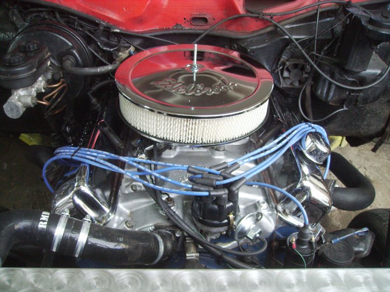

my ocd couldn't handle those too long plug leads so i've ordered a pack of 9 (one spare) terminals from ebay for under a tenner so they can be cut to length.
Neatness can't be faulted ... or is it the dreaded OCD !!

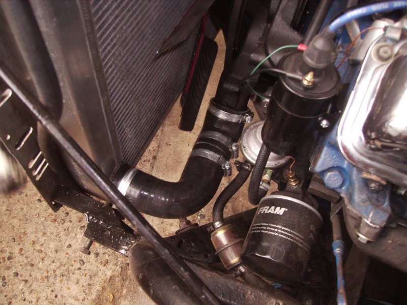

the new rad's mounted and it clears the flexfan by a good 1/2". the back of the fan's about 1/8" from the crank bolt and alternator pulley but as revs pick up the blades flatten so those gaps will increase. we measured up for silicon hoses (black) and ally joiners so i'll get them from rally design. we even found a steering wheel boss that can be turned down and threaded for ashley's red flake steering wheel he got for his birthday 2 years ago, lol. lastly today we bled the brakes, now we can free off the front calipers.

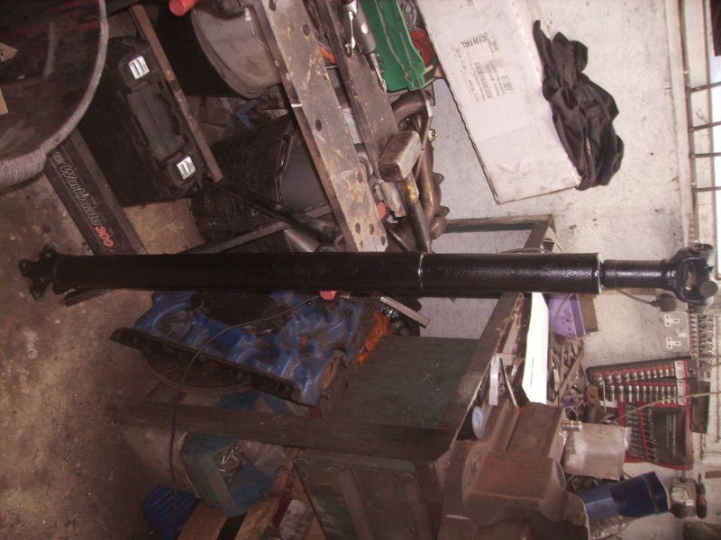

today we got the propshaft made, the new conversion uj fitted and then painted it. then the 'found' boss was turned down, drilled and tapped for the 3 retaining bolts (stainless allen bolts of course) and fitted with the new red flake wheel.

the silicone hoses are cut as required and fitted, then the system was filled with water (it'll be swapped for antifreeze after running up to temp' to check for leaks). the pcv valve and grommet from the old rocker cover is now fitted and after adding a vacuum fitting to the inlet a hose was connected up. we fitted the propshaft and lastly bolted the horns and relay back in place.
