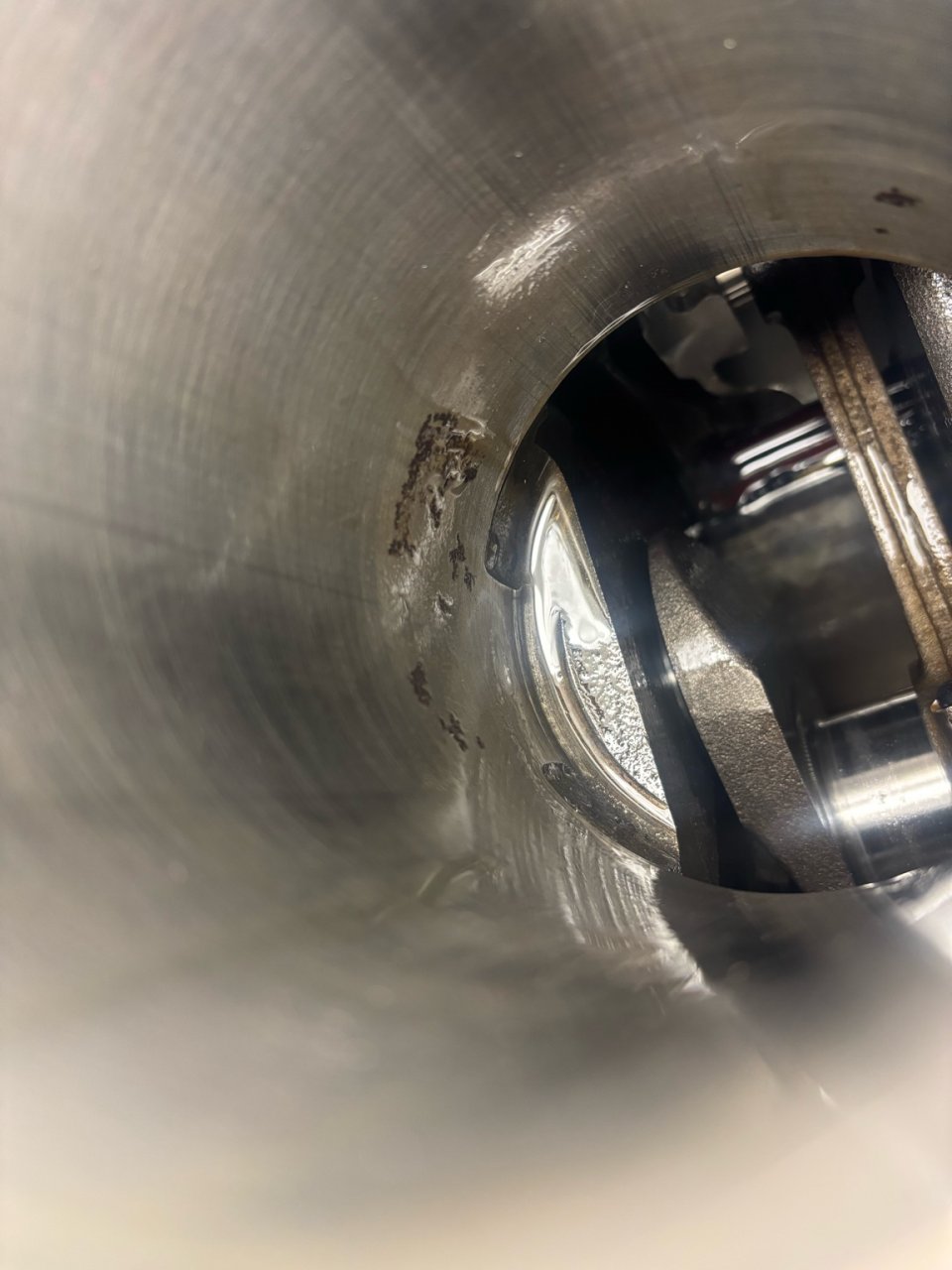

when the motor is cold sounds fine as warms up I got a knocking.. got the old screw driver to the ear .. pinpointed noise to number 5 or 7 … I reset all valves … same again quiet when cold .. once warm a knock … not a really bad knock but a knock .. thought could be a wrist pin knocking … just pulled no 5 and no 7 .. where the noise was … at the bottom of bore number 5 there is some rust .. now this engine i put together 3 year ago had been kept dry and turned over every month … my question is could this rust at the bottom of the bore be causing my knock once it all gets warm? Or would you lean towards a wrist pin prob? Pins feel tight in rods when out but they are obviously cold … heeellllpppp
Attachment 66499Attachment 66499
