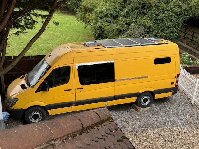

(I've also built a Sprinter Campervan conversion from scratch for my daughter
Attachment 62952
Thats a whole other story and not for this forum :thumbs_up_smiley:)

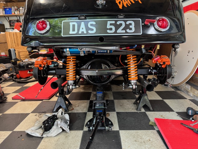

The brake pedal was rebuilt and the pivot point lowered 2 inches under the floor.
The front brakes have improved but th back ones are still not great.

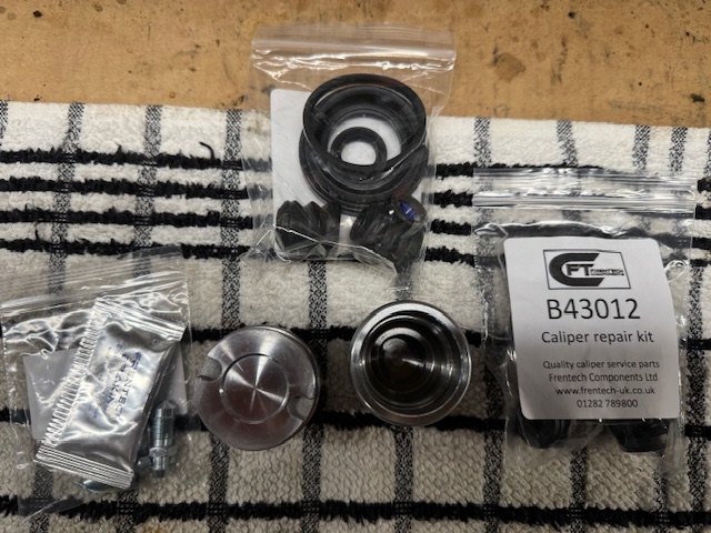

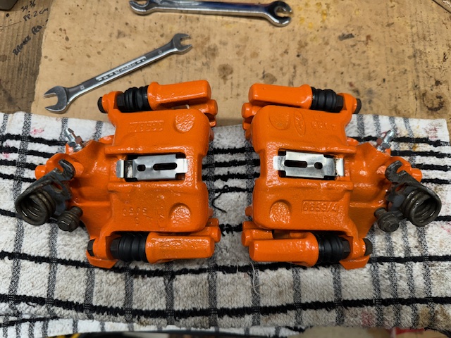

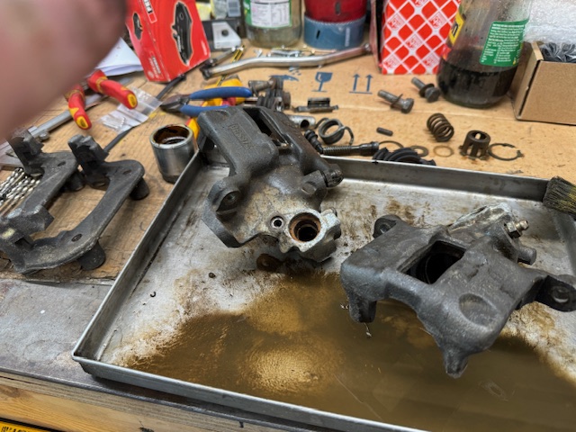

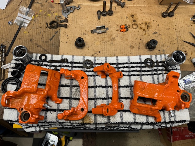

I have just powder coated and refurbed the Cosworth rear calipers the car came with and will be re-fitting them soon to try and improve the efficiency.
The current handbrake arrangement is also very poor so that should improve with the referb callipers.

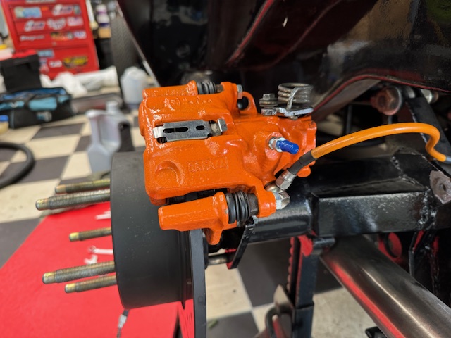

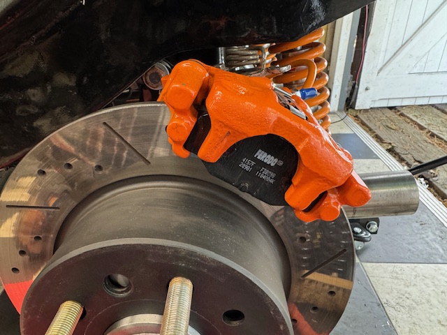

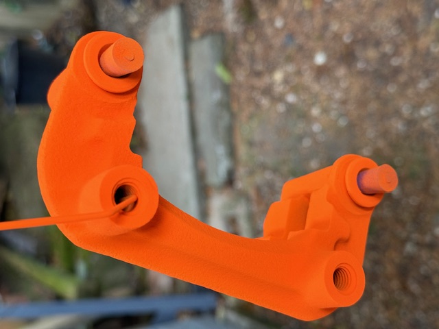

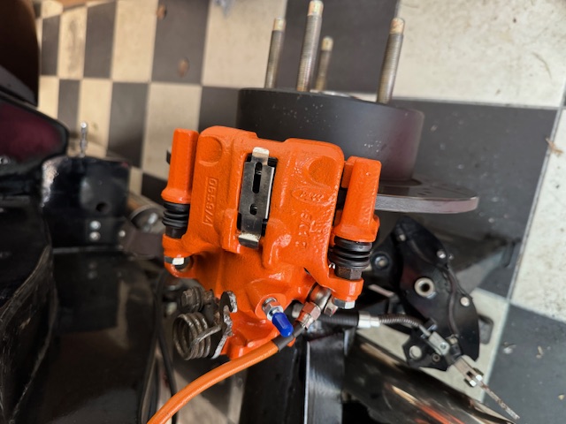

Two months on and the rear calipers are finally back on the car.
I had all sorts of problems with leaks from the hoses.
The calipers being replaced used a banjo bolt and copper washers, no leaks at all.
On the Cosworth calipers I couldn't get them to seal even using new copper washers.
I finally found some fitting from CBS that worked, no more leaks.
The brakes were bled until there was no bubbles but the pedal still feels a bit soft.
Attachment 63509
These pics are with the banjo bolts before I noticed the leaks!

Whilst doing that it might be worth carefully examining whether the orientation of the caliper makes the bleeder port draw from the exact top of the cylinder. Might be the pic but it does look like it might not, but rather marginal? If it's not just bleed with the caliper loose and one bolt removed. Should allow for some repositioning.

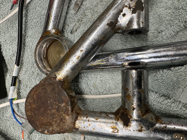

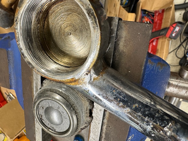

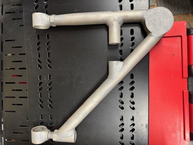

After a brief discussion over on the Tech section I've decided to try and blast the chrome plate off the suspension arms and powder coat them.
I will also replace the blue polyurethane bushings as they appear to have gone a bit soft.
Attachment 63605

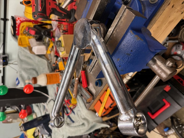

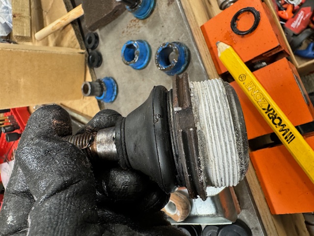

Removed the arms on the nearside to start, bushings all came out fine then to remove the balljoint.
I didnt have a spanner that fitted so ... in the vice and wack with a large hammer :whistle:
Attachment 63606
Are finally came off after a bit of heat was applied aswell.
For those interested the IRS is a Yorkshire Street Rod part.
From the little I could find on the web mine looks like the last version made.
The ball joints are from a Talbot Solara.
I know this as I have just got 4 new ones arrived!

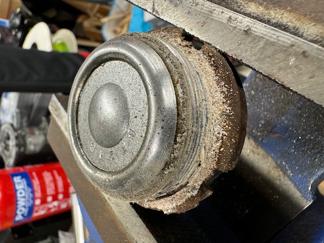

We can now see the stare of the plating.
Attachment 63608
Attachment 63609
When I get some time I will go to the shed and run up the blast cabinet and see what damage I can do.

Good job they're not the earlier YSR version with the catastrophically failing Transit track rod ends inappropriately used as balljoints.
Can't even remember what a Talbot Solara looks like!

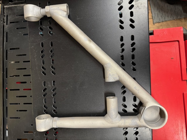

Nothing too write home about !Attachment 63610
basically an alpine saloon.
An hour and a halfs blasting with 70 grit ally oxide.
All the loose chrome plate and rust is off and what evers left is stuck and well keyed.
Attachment 63612
Attachment 63613
Next stop powder :)
