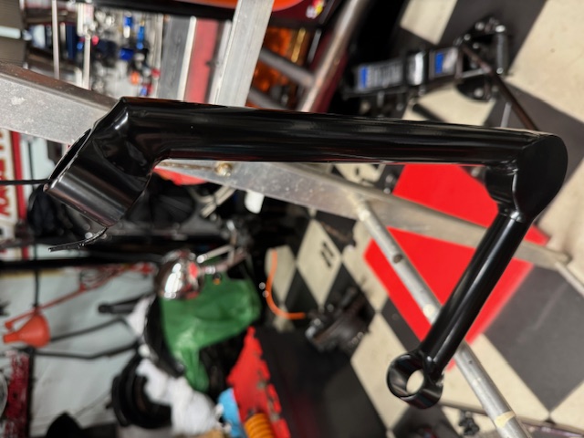

Had a successful afternoon in the shed.
A-arms and a few curtain pole brackets coated satin black.

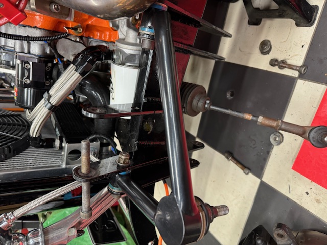

Bit more done.
Blasted old paint off the spindle hub.
Attachment 63689
Before coating you use silicon bungs to fill the holes you don't want powder to get into.
Attachment 63690
And heat proof masking for other areas you don't want coated.
Attachment 63691
This is the electrostatic gun I use.
Attachment 63692
Coated with Satin Black powder.
Attachment 63693
Out of the oven.
Attachment 63694
Attachment 63695
All back together.
Attachment 63696
