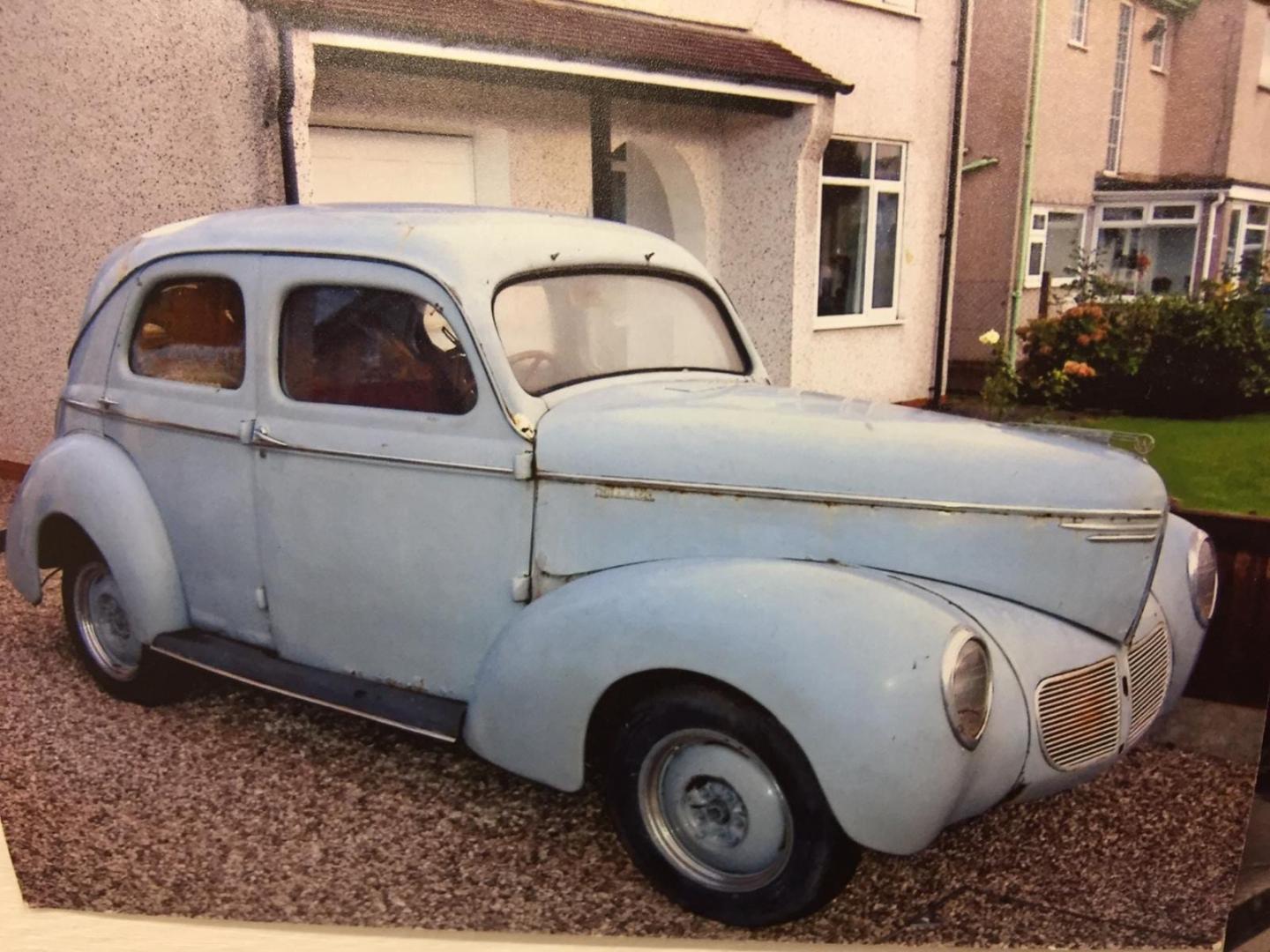

Here's how it was when Steve bought it,the world is now a less ugly place now its been couped :yes:

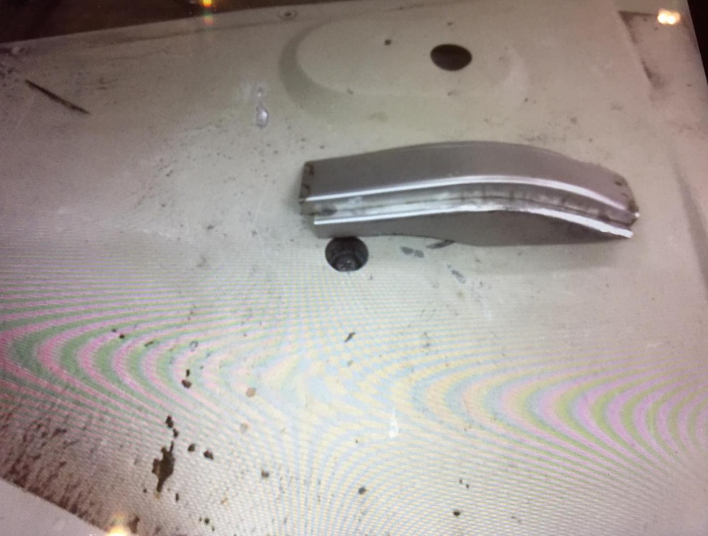

any build shots of the coupe conversion?

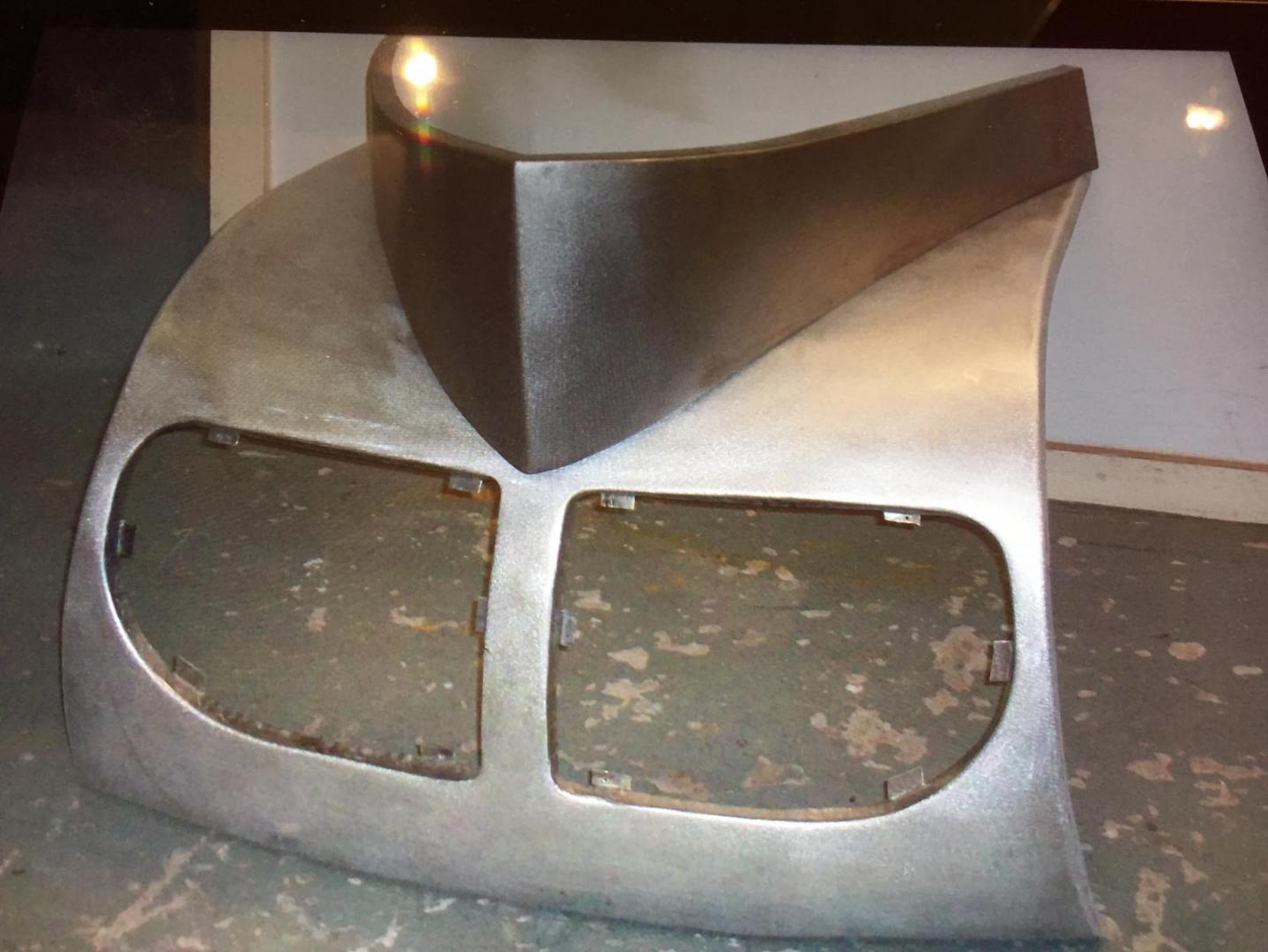

Steve ordered the coupe panels of a guy in the States who reproduces them quite accurately,and tells you what you need to do,almost as a kit you might say.
Steve is looking in and will probably feed me some more photos i can post up .
But the basics of it are that you cut the 'coal bunker' of the back of the sedan,weld the kit on,fit a part of the rear door to the front door then later that afternoon cruise around the block in your new ride ,without it now full of kids dogs and picnic equipment :)

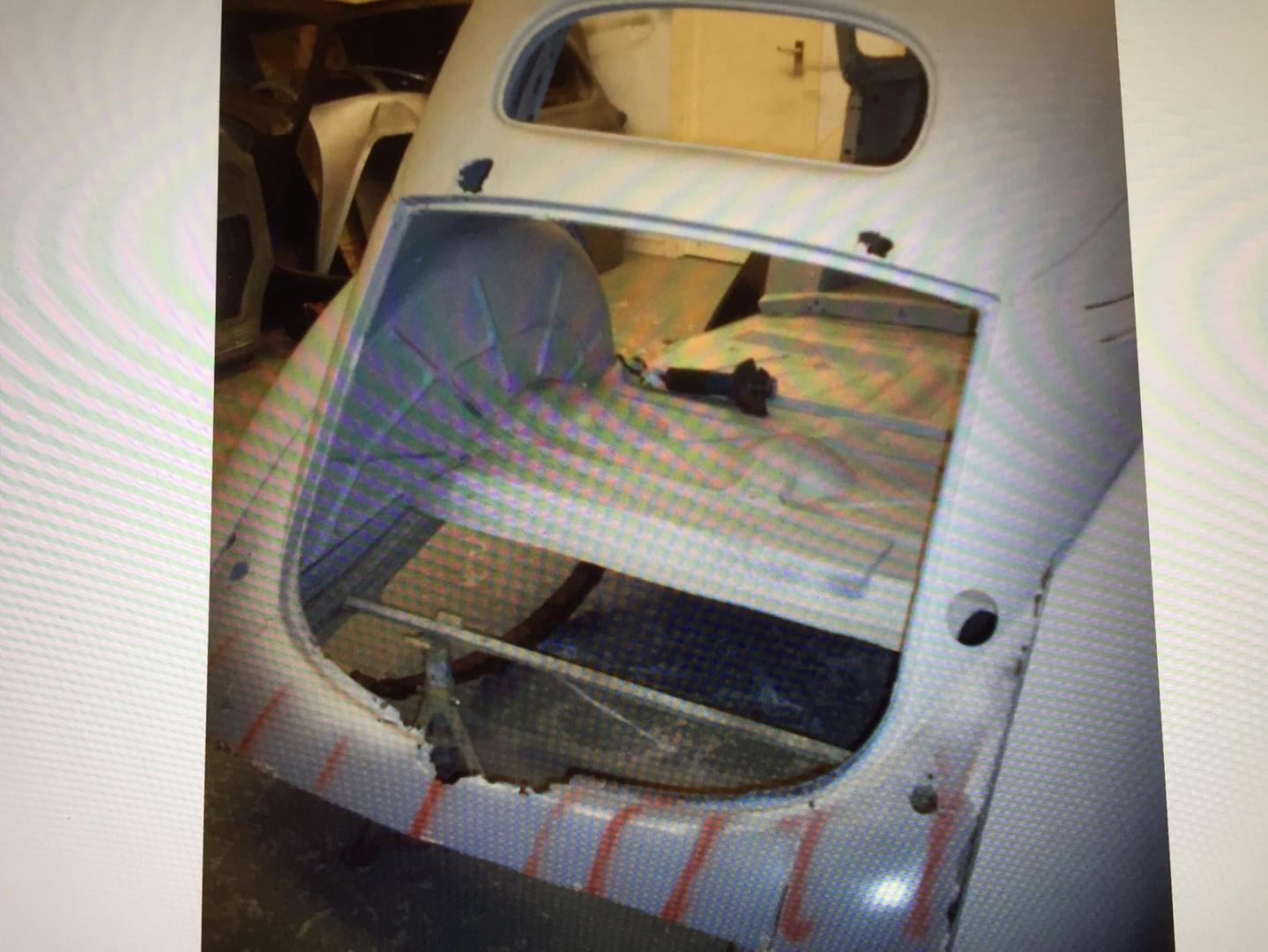

Of course we know its never that simple [:D],but you get the idea,here is a photo of the rear door bit you need,i think,is that right Steve ?
Attachment 40043

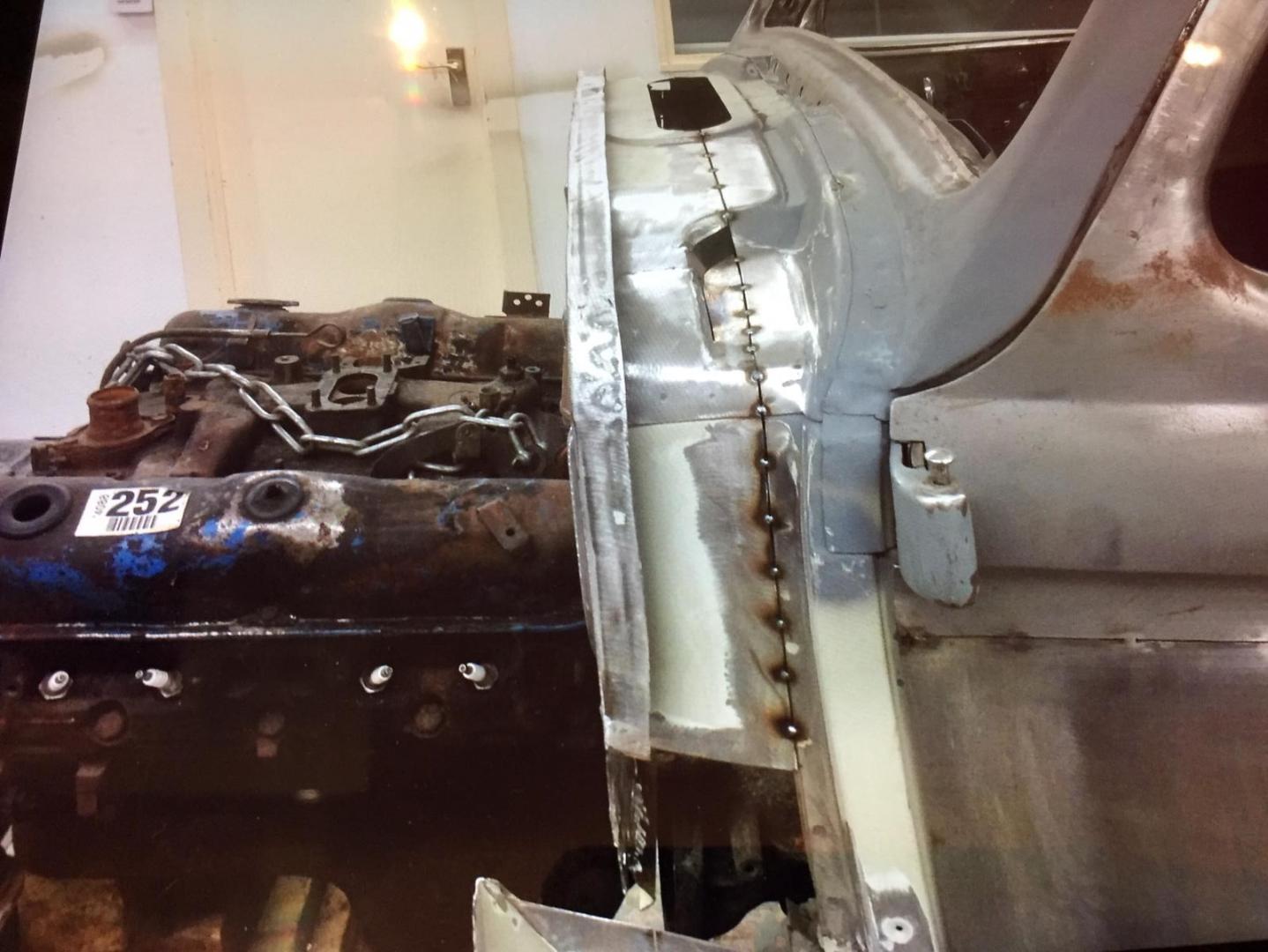

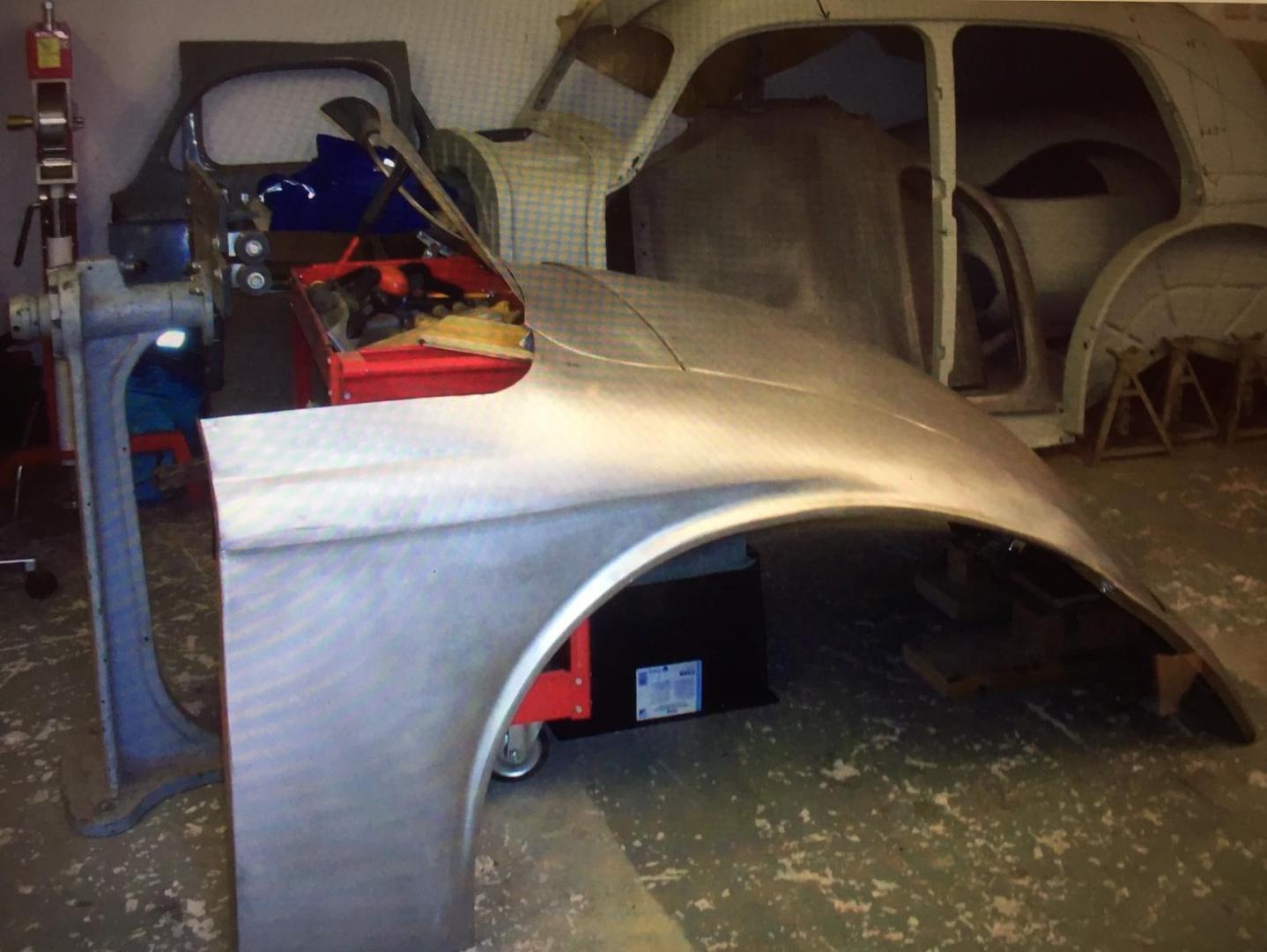

Here are some more of the build up fresh from Steve.

Lee Kay's the man for Willys panels made to order and first class job English guy living in CA check out his web site top man.
Kay's Kustom Metalworks.

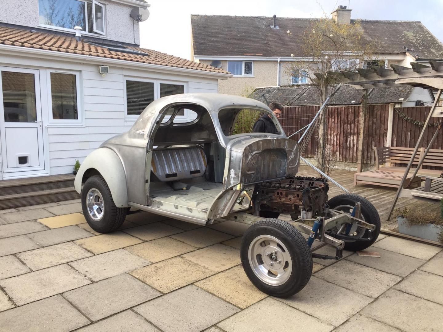

Another update and the fuel tank is in,and the car is out :)

The fuel tank is from a Mercedes and sits in the Mercedes in the same position,not behind the driver,silly,but behind the rear seat.
