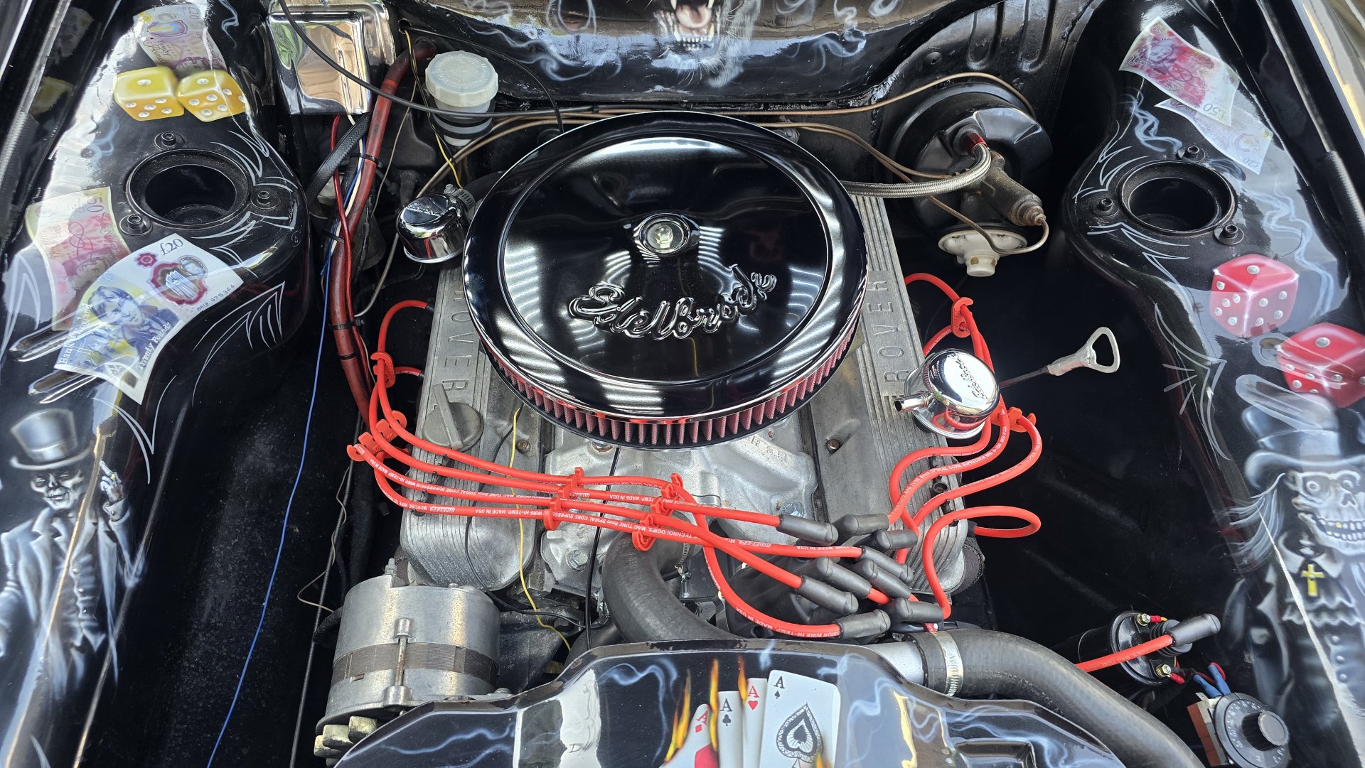

So here's an update on the Hunter. As you can see, I have had some pinstriping done, and there will be some more done soon.
I will be having the brake master cylinder changed to a tandem system, as there was a definate leak. An adaptor will be fitted for the carb which has the PCV valve port.
I also need to get the electric power steering working, all of these jobs will be done at Thunder Road Speed Shop.
