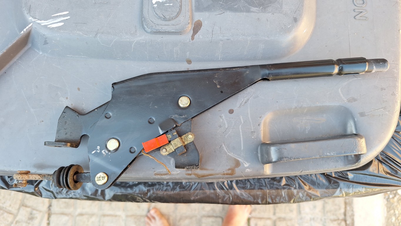

I mentioned I bought a handbrake for Andy's car, it arrived a couple of days ago. It had to come from Latvia where they still have scrapyards https://storage.proboards.com/forum/...ley/smiley.png
It's a Ford Scorpio handbrake - same as the one in my car. I like them as they have a nice flat double mount and 11 clicks and a long handle so it has good leverage and about 30mm of draw on the cable.
It needs a bit of a scrub but it's in excellent condition.

And stripped down. I like that it also has a discreet handbrake warning lamp switch built in.
