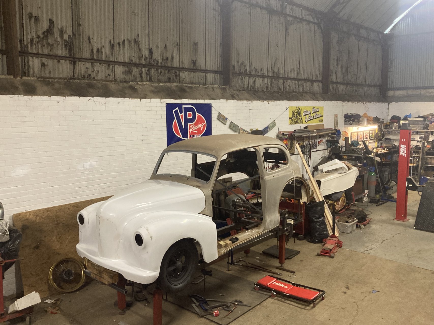

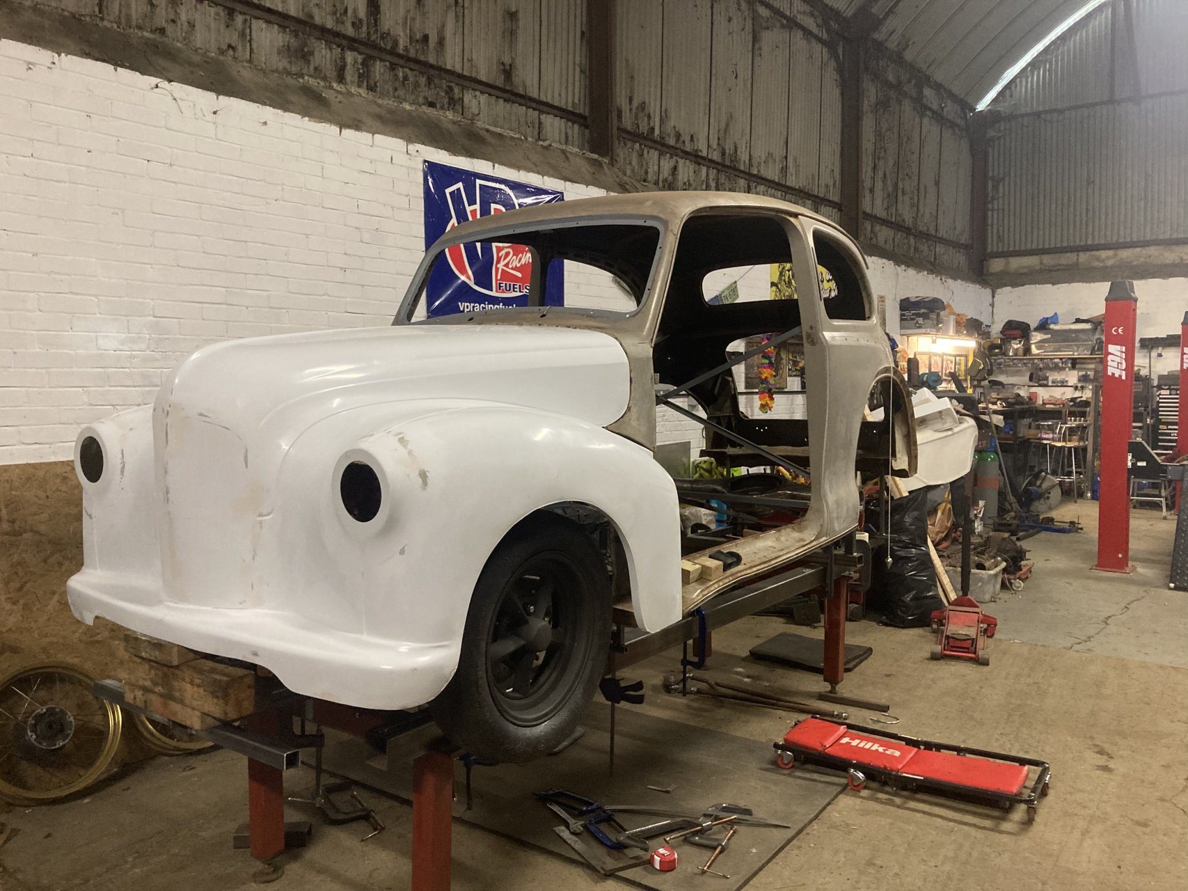

Some progress this evening. All just plonked on the jig.
Lots of moving around req, Body needs to be lower at the rear and also moved back.
Engine height and position can be looked at along with drive line and pinion once i have sorted the ladder bar fitment.
Todays Update!
Made the body a bit more secure on the jig and centralised.
Centralised engine and box, height and set back to be confirmed.
Hubs on to check wheel in the new front and not looking bad at all.
Some lightening of the boot lid a bit more.

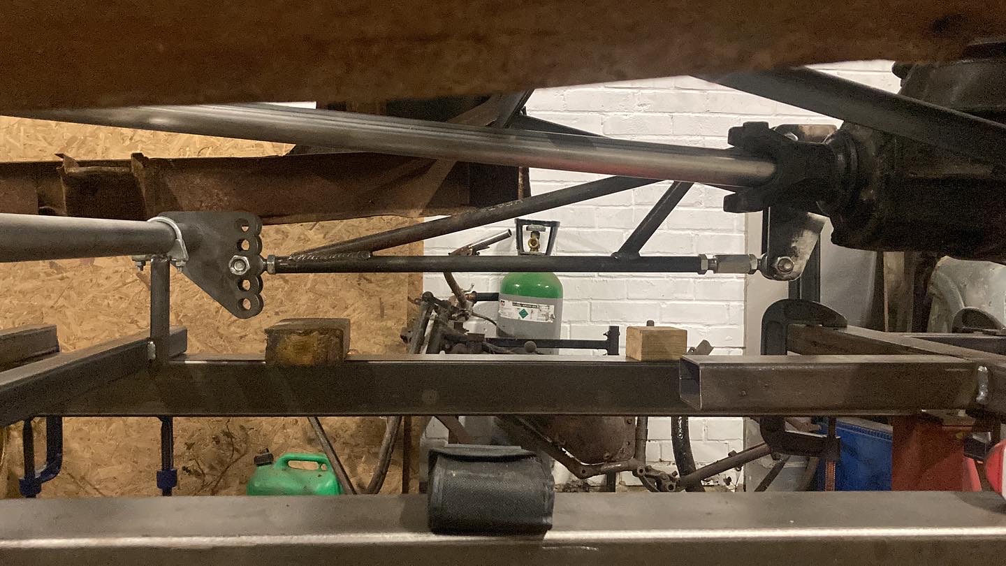

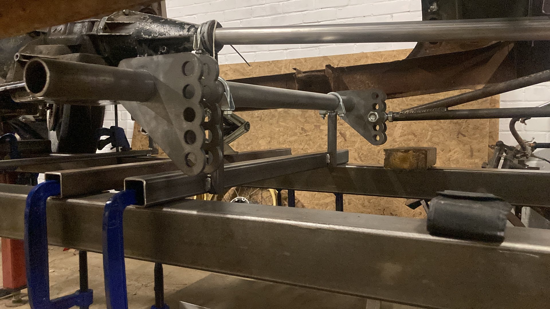

Some workings out for position of ladder bars on rear axle.
Ladder bar front X member started.
Shaving down the axle brackets to get a better fit to the casing.
Some slow progress last night.
Measuring up ladder bars.
Working out the mid way point on the pinion adjuster with enough thread still in the bar.
Getting the ladder bars symmetrical and working out any discrepancy that we found.
Pretty much there with the best setting, adjusters as neutral as possible.
Front bar mount will have a fixture to the jig next with the middle hole at a whats thought to be good position.
All holes will then be checked and recorded. We may not get all adjustment holes with the correct pinion angle but modifications to the turn buckle / bar can be made in the future if it’s reaching for the sky ect. Better to have the points than not in my opinion

Last night consisted of making a quick fixture for front ladder bar mounts. Pretty self explanatory, not in its exact final place as of yet but you’ll get the idea!
