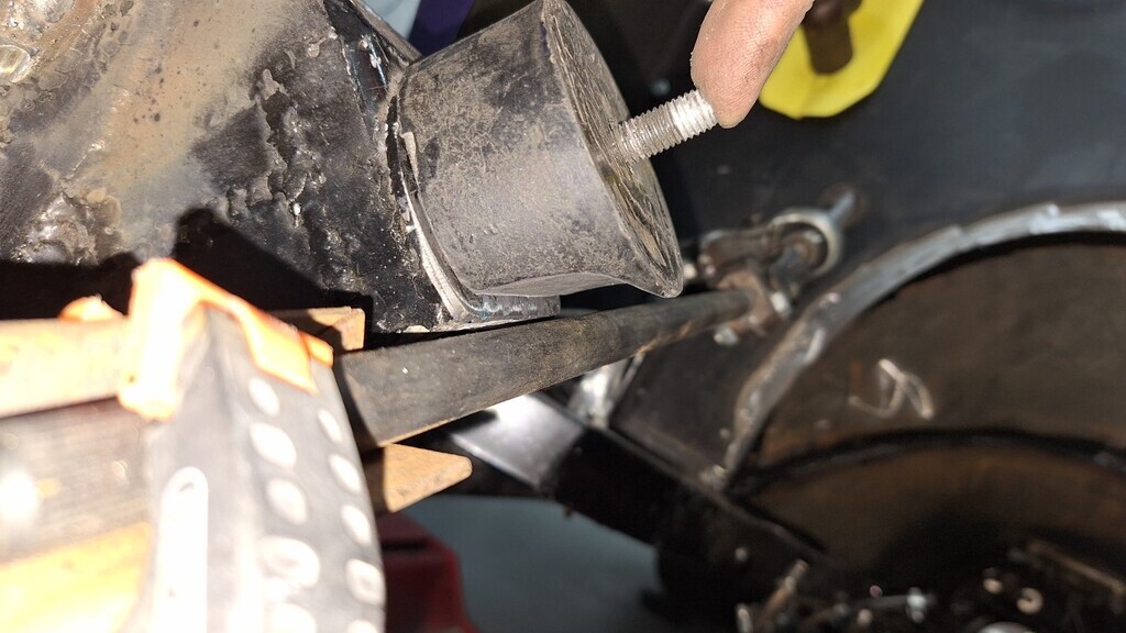

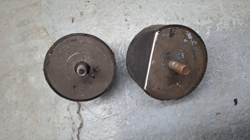

Popped the engine back in again tonight with the exhaust fitted to see what clearances are like - they are tight. Why Rover stuck the oil pump poking out of the engine like that I don't know but it is a major pain for fitting everything in.
The good news is that it all does fit, but we will be stuck with the tiny oil filter. I've sorted the problem with the engine mount being in the way of the steering shaft, I've trimmed off a bit of the mount and the mounting rubber.
The mount is trimmed back here;
Attachment 66071
https://img.retro-rides.org/i/v/blac...5652816cdc.jpg
and one of the mounts is trimmed back as well;
Attachment 66072
https://img.retro-rides.org/i/v/blac...d5b0346634.jpg
Now it all clears ok https://storage.proboards.com/forum/...ley/smiley.png
Attachment 66073https://img.retro-rides.org/i/v/blac...7c7cab5ebf.jpg

Getting on well with it mate. I take it that engine mount is at 45 degrees Mark, could an angle change keep all the rubber by any chance?
Wasn't the oil pump design of Buicks making? Rover perpetuating it? I dunno!
Made for wrong hand drive cars .... good progress Mark [emoji1303]
My bro-in-law had his own company and was a welder all his life starting in the `50s with arc (and gas/brazing) and later Mig/Tig, making low loader trailers to carry bulldozers etc. He taught me to weld and often said `It`s not how the weld looks, it`s the strength that matters`! Yours looks fine to me...
Tim,
it's sorted now, I only had to trim about 8mm of the side of the mount.

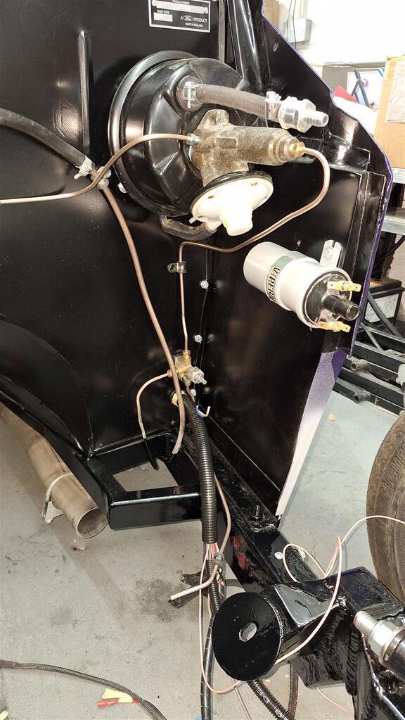

With the remains of the black epoxy primer I also painted the master cylinder.
Attachment 66091
https://img.retro-rides.org/i/v/blac...8bb2a9ac44.jpgMore masking tomorrow so I can paint the front of the chassis in gloss black.

Quick update before lunch. I've been making ally standoffs for the brake fittings, you can get a spanner on them now they are away from the bodywork.
Attachment 66100
https://img.retro-rides.org/i/v/blac...ffc86486fd.jpg
And fitted on the car;
https://img.retro-rides.org/i/v/blac...e13cb75c71.jpg
Attachment 66099https://img.retro-rides.org/i/v/blac...560703e98b.jpg
Attachment 66101
The master cylinder is also refitted and the closing plates temporarily fitted - as they need another coat of paint on them.
Attachment 66102
https://img.retro-rides.org/i/v/blac...07798c95e2.jpg

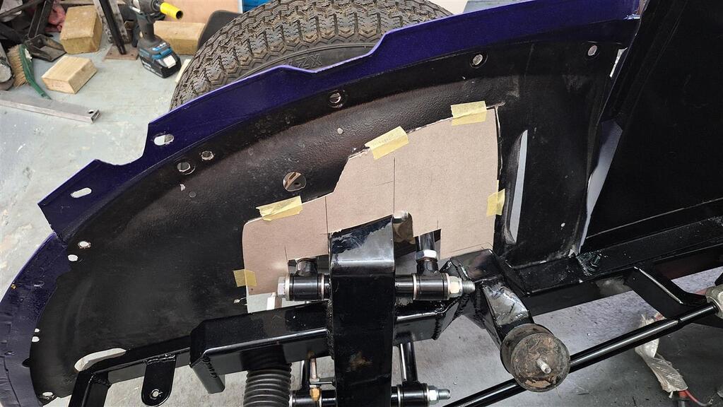

I put the inner wings back on - you can see how someone just chopped them out with a cutting disc and just left the raw edges https://storage.proboards.com/forum/...superangry.png
Attachment 66109
The masking tape is a guide as to where I'll make some new aluminium plates to get the wings a good fit around the suspension again.
https://img.retro-rides.org/i/v/blac...78e9368099.jpg
Attachment 66107
The strip of tape at the top will drop to the chassis.
Attachment 66108
https://img.retro-rides.org/i/v/blac...455b5a46ea.jpg
https://img.retro-rides.org/i/v/blac...9674100be1.jpg

Yesterday I templated the new filler peices for the inner wings. I've decided to do them in steel as our ally is 2mm thick and does not bend easily. The inner wings have compound curves in them and also there is not much material at the back to fix to, so it will be far easier to shape in 1.2mm steel & weld them all back in. I may also cut holes in them and add a reverse scoop to allow hot air out of the engine bay.
Attachment 66111
Attachment 66112

After that I started getting the wiring back into the engine bay from the car. I slimmed the wiring down a bit and managed to get some of my cable trunking over it to protect it where it passes through the bulkhead sleeve. Much happier with that, no chafing possible now.
Attachment 66114
The coil got fitted and then I started making the new brake pipes which always takes an age to work out the correct length and shapes. First one from M/C to servo fitted here;
https://img.retro-rides.org/i/v/blac...68b63b83da.jpg
Attachment 66113
And the second one from the servo to the 3 way connector here - this is the MkII version https://storage.proboards.com/forum/.../notamused.png I used a bit of the old pipe to make a trial section for the take off for the front brakes, which is the loose bit at the bottom of the photo, should make that section a little easier to make tonight.

New mounts are starting to get made - basic plates cut so far (old ones in background) as the old ones were modified after one of them fractured and ended up busier than I had planned (they originally had the single plate holding the tube & I had to add the extra side plates after the middle 6mm plate fractured). The new ones will be smaller and stronger with the double 6mm side plates.

Next was cutting the inner wing infill panels, my cheap air powered shears from Lidl actually worked pretty well! saved a lot of work & mess with the grinder and I just finished off with the snips.
https://img.retro-rides.org/i/v/blac...f40f7c62dd.jpg
With only 20 seconds of shaping over a bit of tube and it's nearly a perfect fit, result.
