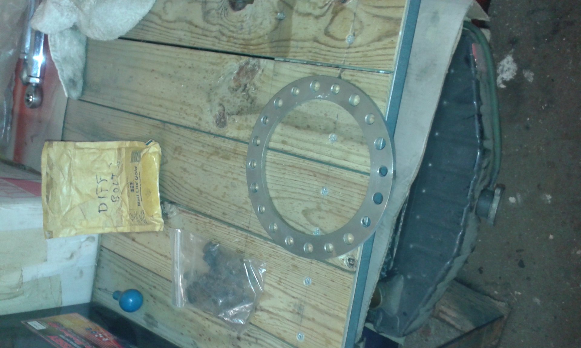

the new 'shims' for the ring gear are made and the bearing shims juggled side to side 'til the gear backlash is right. this was made easier as we'd flap wheeled the inside of 2 used bearings so they were a tight sliding fit on the diff allowing them to be removed and refitted while changing shims. we'll get the new bearings pressed on now we have the shim situation sorted. we ended up with 1x5mm and 2x1mm crown wheel shims (see pic) as that's what sheet i had to get me closest to the just under 7mm we needed. that's the reason for the bearing shim juggling as we'd got the bearing preload set with the required shims already. as soon as the longer ring gear bolts arrive we can get it all buttoned up. :thumbs_up_smiley:

That's what I had to do with my diff, we tried to get the pinion to mesh with the ring gear with an LSD & couldn't figure out what the issue was (this was a few years ago now). Found out about these spacers & once fitted, hey presto! That's apart from finding issues with the casing I'd had blasted & painted ready to go in, only to find the half shaft bearing recesses had a difference which meant the bearings & thrust bearings didn't fit! So had to go back to the original casing & live with the old original paint finish! Oh the joys of building (or in this case, rebuilding) a car! Anyone want a bunch of Jag diffs? :whistle:

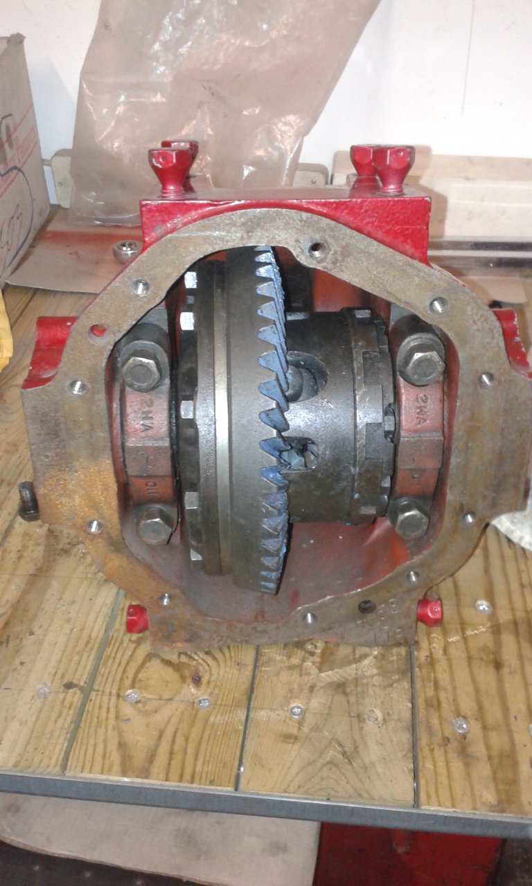

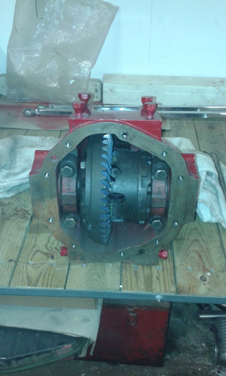

the longer bolts arrived for the ring gear this morning so this afternoon we got the new bearings pressed onto the lsd and the new bolts torqued up. the axle's now fully rebuilt ready to go. we plan to loosely assemble the open jag diff into the jensen axle, but.... with the lsd needing a big lump of shims to get the ring gear close enough to mesh with the pinion this probably means the open diff would be 'too' close to the pinion to fit. to keep the pile of loose parts to a minimum we may just fit the diff with no ring gear so all the other parts are inside the axle.
This is what I used to shim the pinion over enough to mesh with the ring gear when using an LSD. If you compare the first pic with the last pic you'll see the difference in spacing between the pinion gear & the ring gear teeth, the middle pic shows the ring gear spacer. It comes as a specific kit to allow an LSD to be fitted to a diff without an LSD, includes longer bolts. No "big lump of shims", just a custom made spacer! :thumbs_up_smiley: Too late now I know, but this is how I did mine after a lot of trial & error.

i didn't even look to see if there was spacers available, let alone a kit with longer bolts too. it was quicker to make spacers than wait for parts so.... :thumbs_up_smiley:
