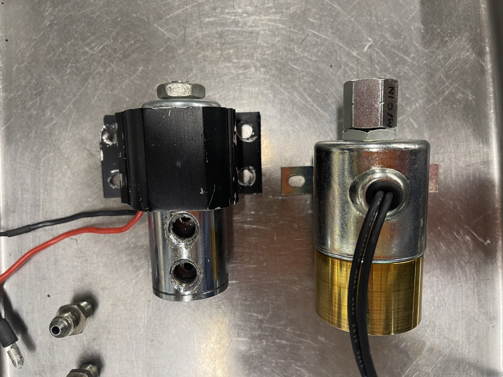

New line lock arrived

Much better build than the Hurst rip off.

Got the new solenoid in place after a lot of cursing and skinned fingers. It mounted on the chassis rail under the drivers seat.

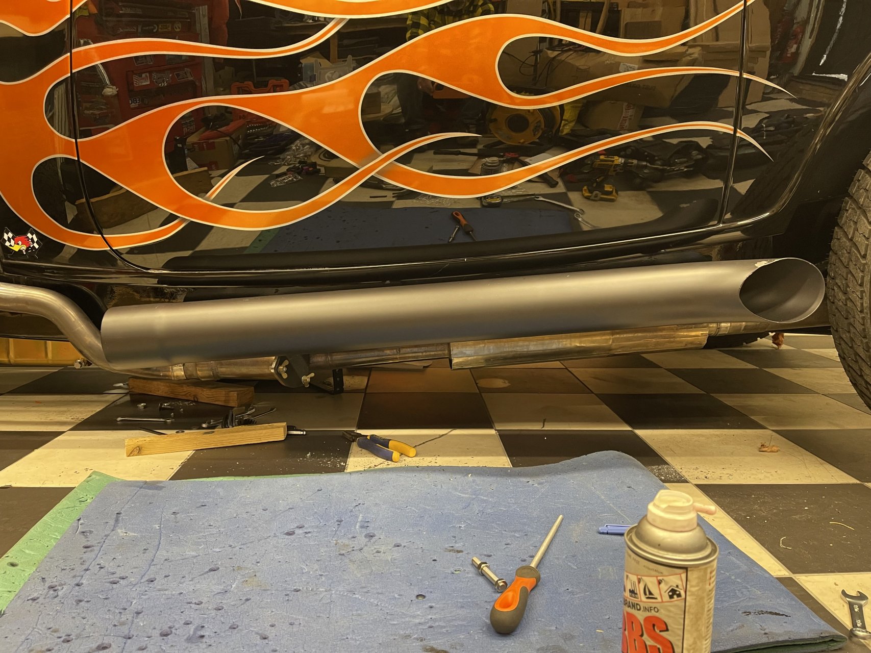

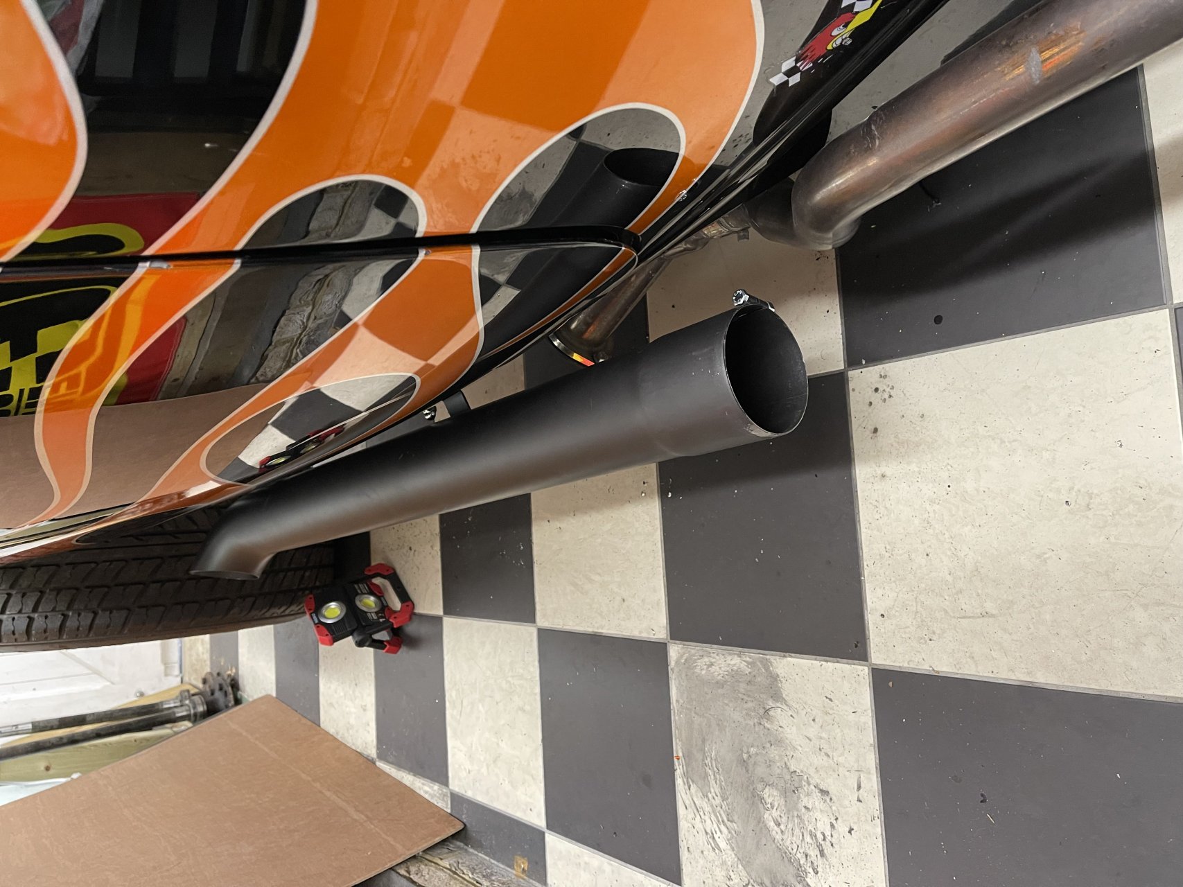

It was easy t put in originally but now has the exhaust sitting just below it so access is tight.
Eventually the exhausts will move to side pipes on the outside of the chassis.

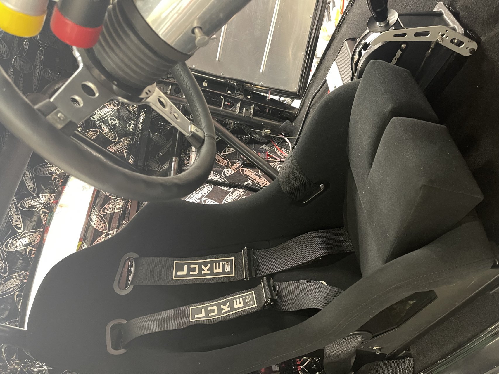

Had a busy couple of days in the garage.

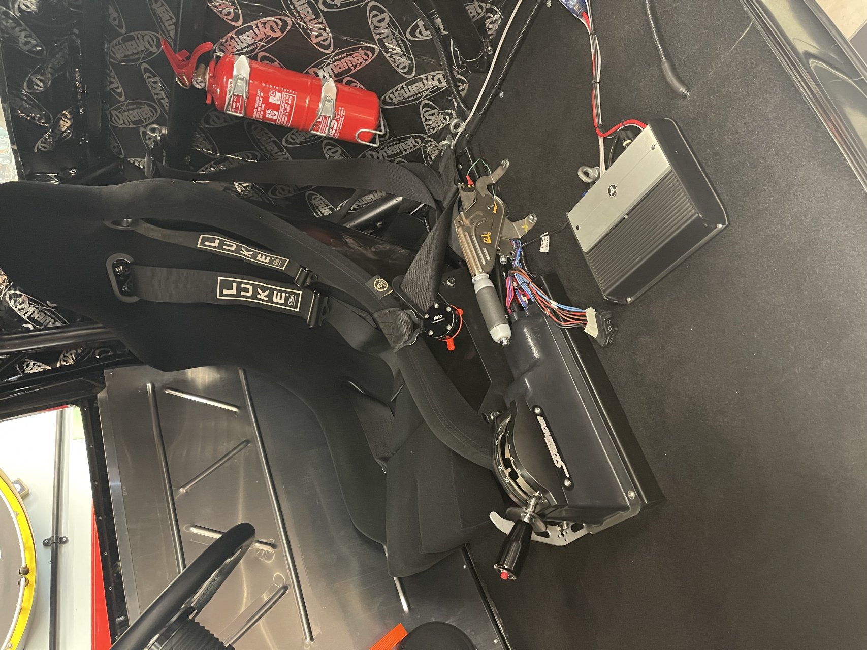

Drivers side seat mounts bolted back in. These are bolted through the chassis members then the seat runners bolt to them. Nice and solid.
Shifter and handbrake lever back in.
Harness back in.

You can see the parachute release lever by the shifter.
http://www.torquedup.co.uk/forum/ima...51a27ddca2.jpg

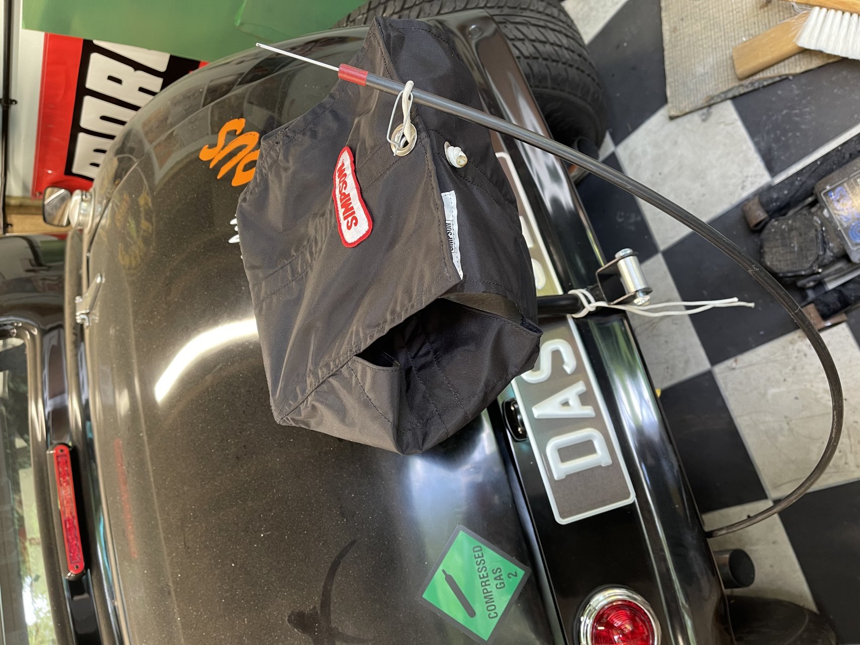

Parachute release cable trimmed to length and fastened under the floor.
http://www.torquedup.co.uk/forum/ima...51a2a7ea18.jpg

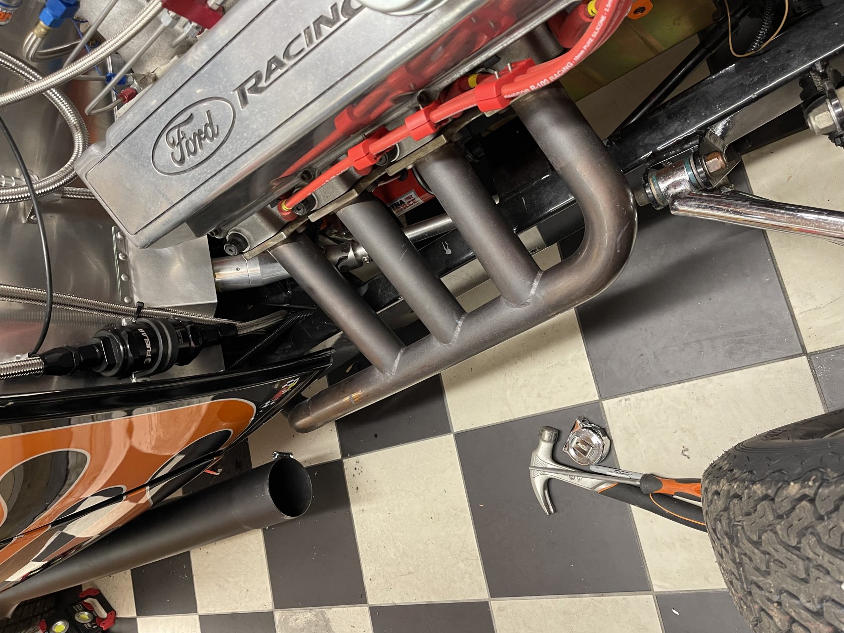

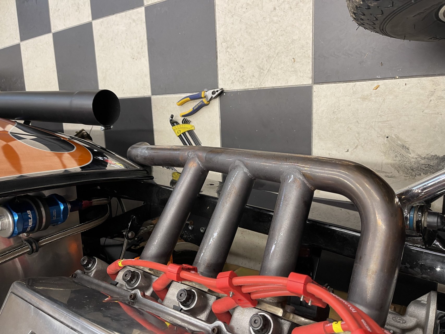

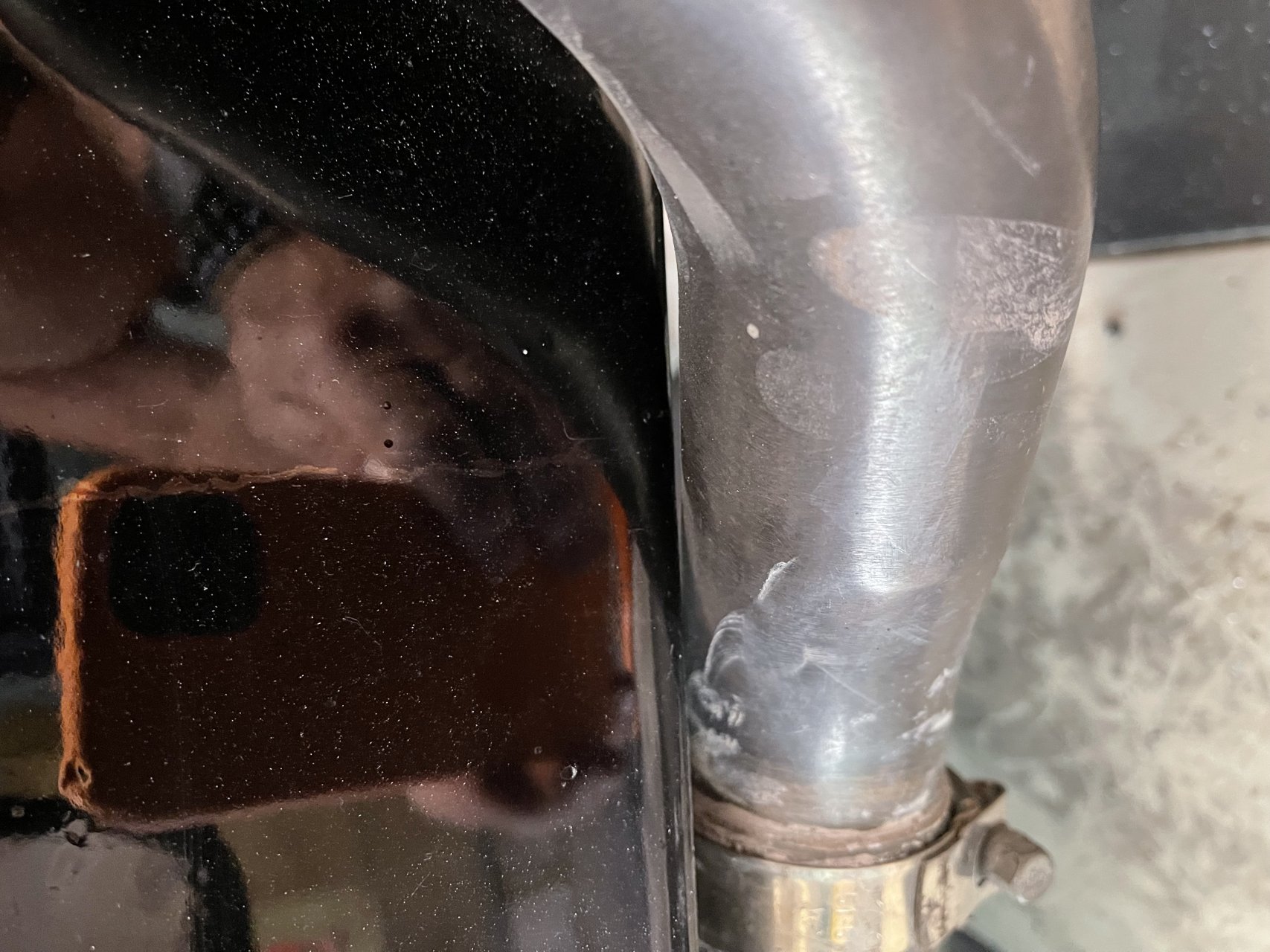

Have got a loud clatter where the exhaust is banging on the chassis! This will be cured with the side pipes later this year.
http://www.torquedup.co.uk/forum/ima...c2993f2a30.jpg
Attachment 56364

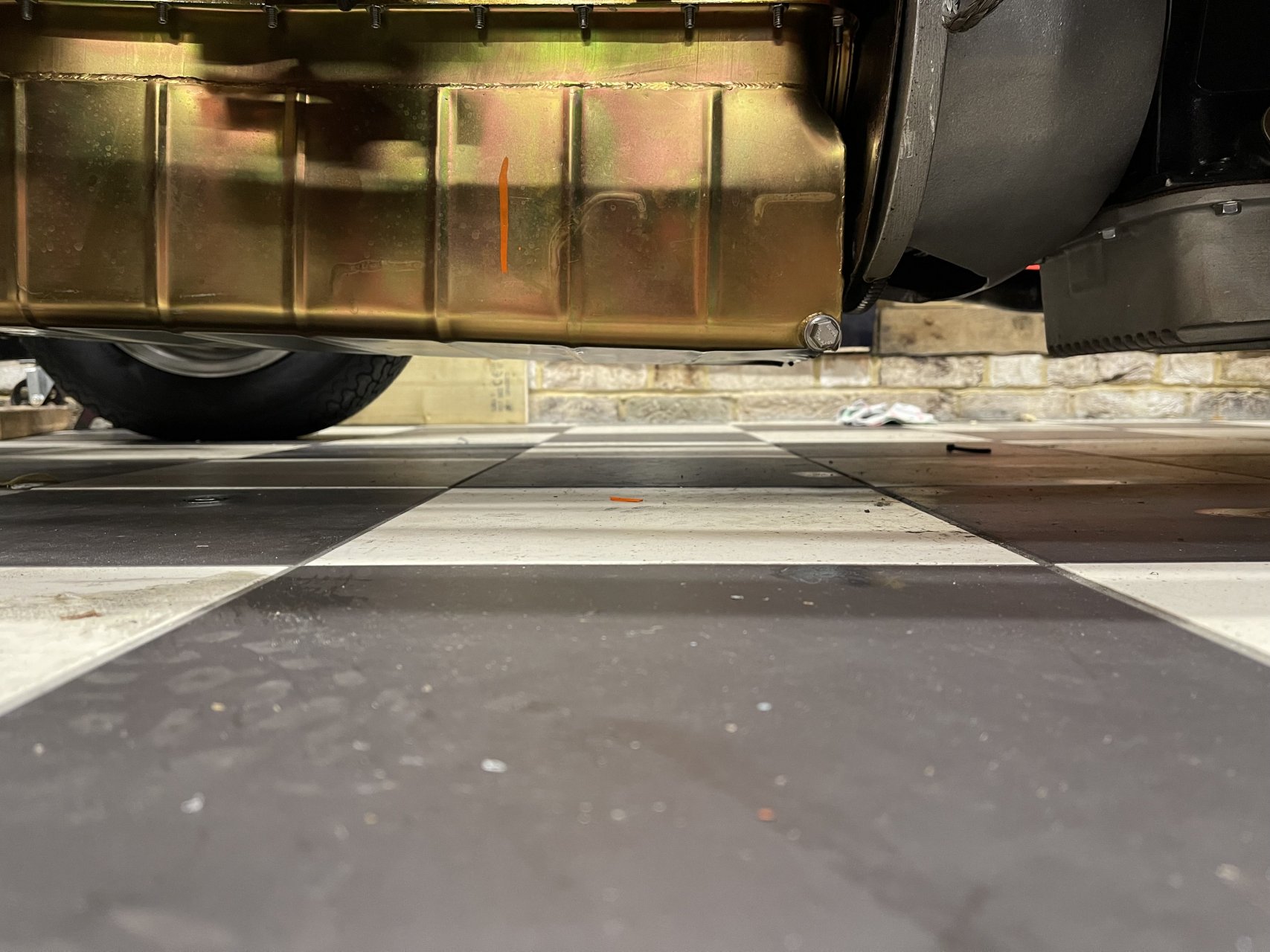

Then found out I'd forgotten to fix the rocker covers on...oil down both sides of the engine all over the floor.
At least I know the oil is reaching the rockers OK, have been worried about this since I buttoned it all up.

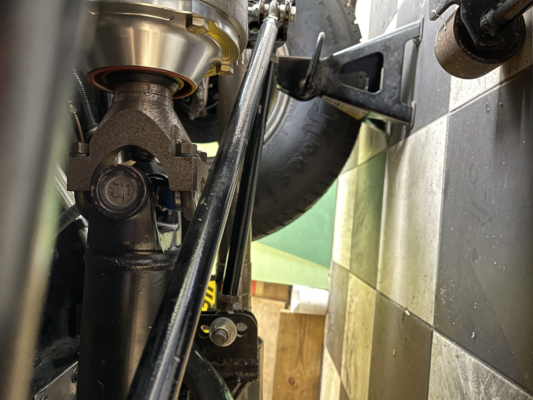

Next problem the new yoke on the diff hits the diagonal link, so will have to move the LH bracket down on the chassis mount.

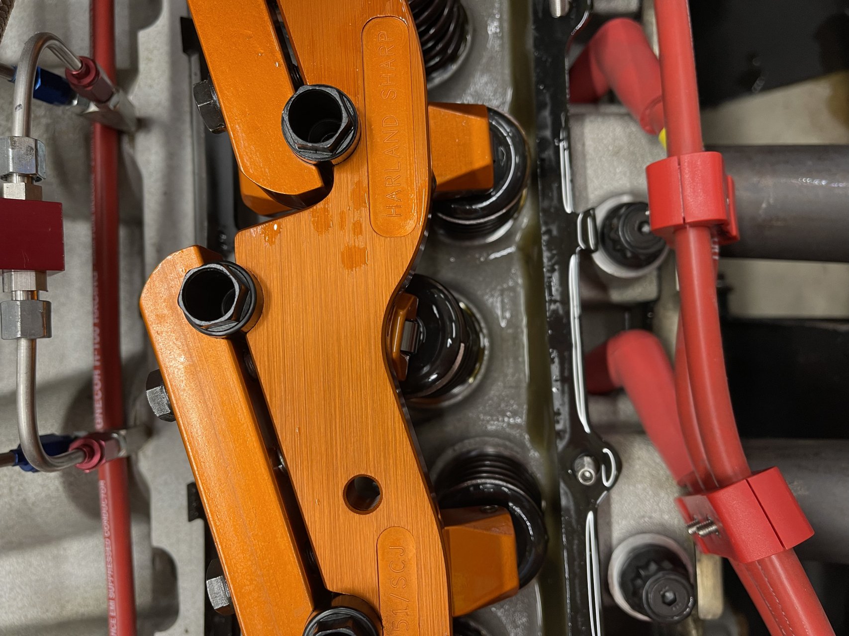

Now she was warmed up thought I'd check the timing.
Bu**er can't see the timing marks. Had to remove the alternator to get to them.
Fired her up again pulled the trigger on the timing light marks on the balancer are showing 270 degrees???
Removed all the plugs turned her over by hand. Definitely got TDC on the compression stroke, distributor is in right with the rotor arm pointing to where 1 should be.
Replaced all the plugs etc. fired up first press of the button, ticks over OK at about 650/700rpm.
Tried the light again, still shows 270ish degrees.
Any one got any ideas? http://www.torquedup.co.uk/forum/ima.../icon_beuj.gif
(24/07/22)
Just found a mention of dial back lights and MSD ignitions having issues...maybe that's the problem.
Will investigate further.
In the meantime I've stripped apart the back end again and moved the lower 4 link arms down for more clearance for the yoke, then re-assembled it all again.

(01/08/22)

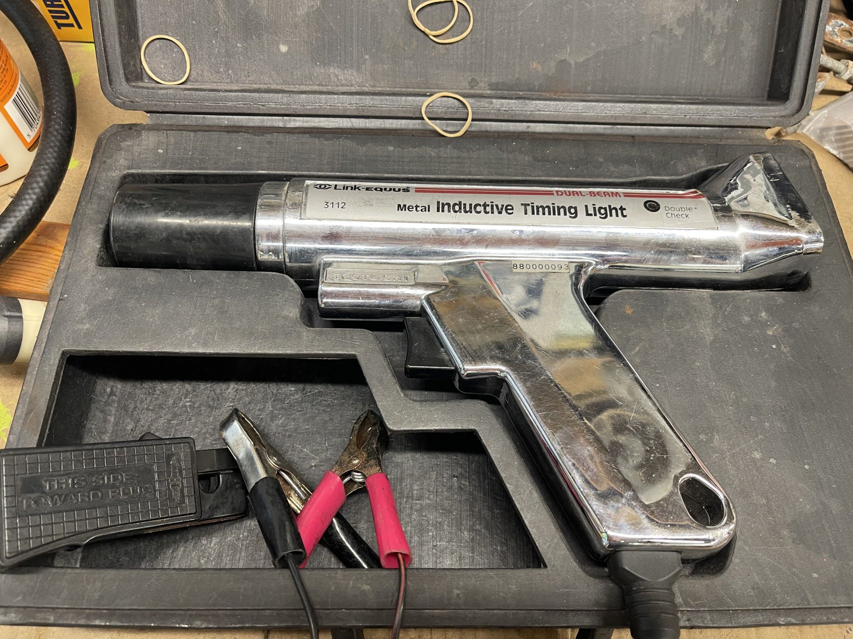

Been away for a few days. On my return this was waiting for me http://www.torquedup.co.uk/forum/images/smilies/tup.gif
Old school inductive timing light, no bells or whistles, just smells of old oil.
http://www.torquedup.co.uk/forum/ima...7da1e513b2.jpg
Attachment 56348
Attached and started up the engine, pointed at the timing marker and surprise, surprise it was reading 20 degrees BTDC.
Adjusted back to 14 degrees and now starts and idles perfectly, result!

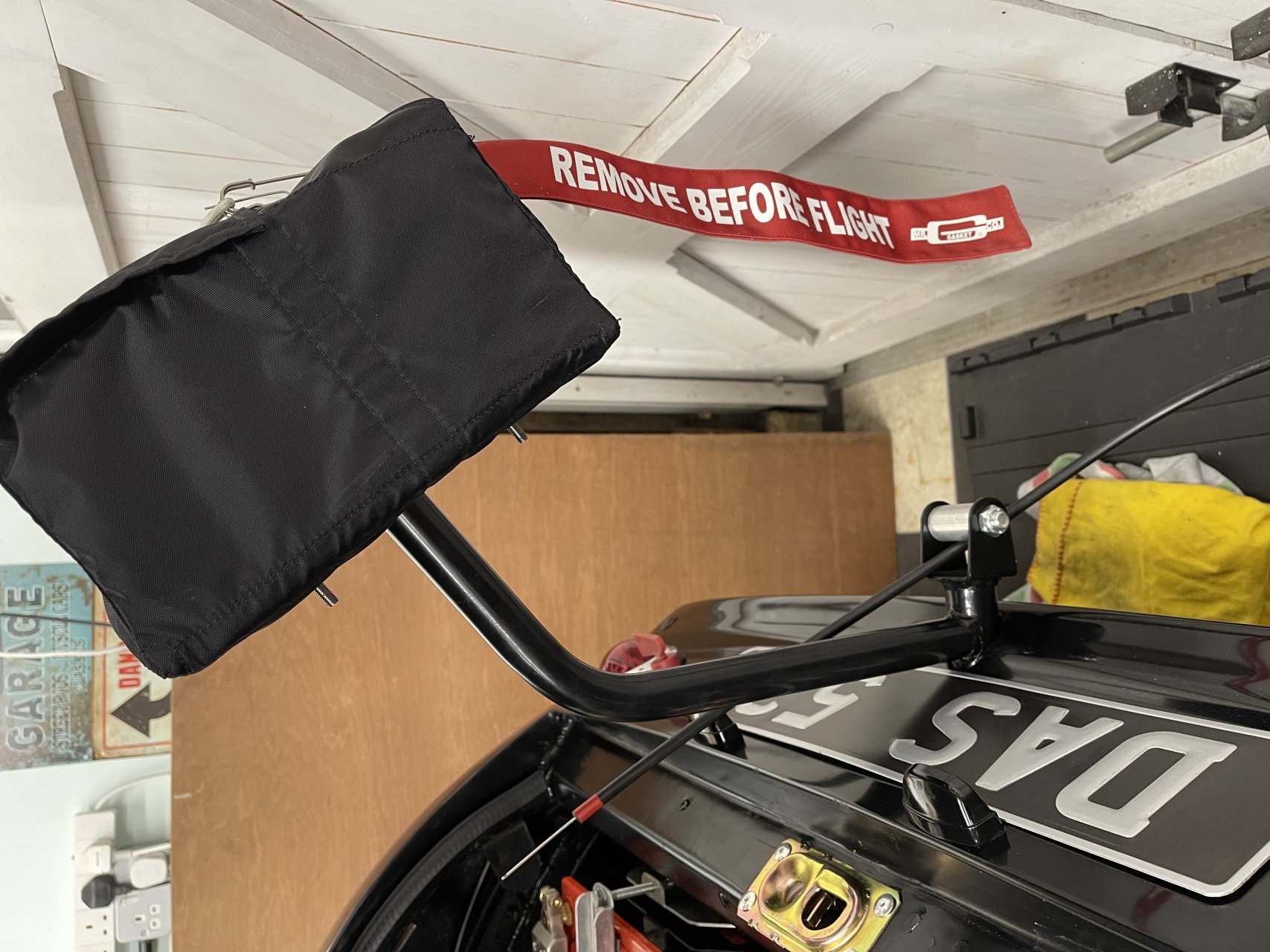

I did coat the parachute mount but the powder coating is fractionally thicker than the paint so now the mount won't fit in the hole http://www.torquedup.co.uk/forum/ima...icon_angry.gif
Will have to wet sand the mount and inside of the mounting tube to gain clearance.

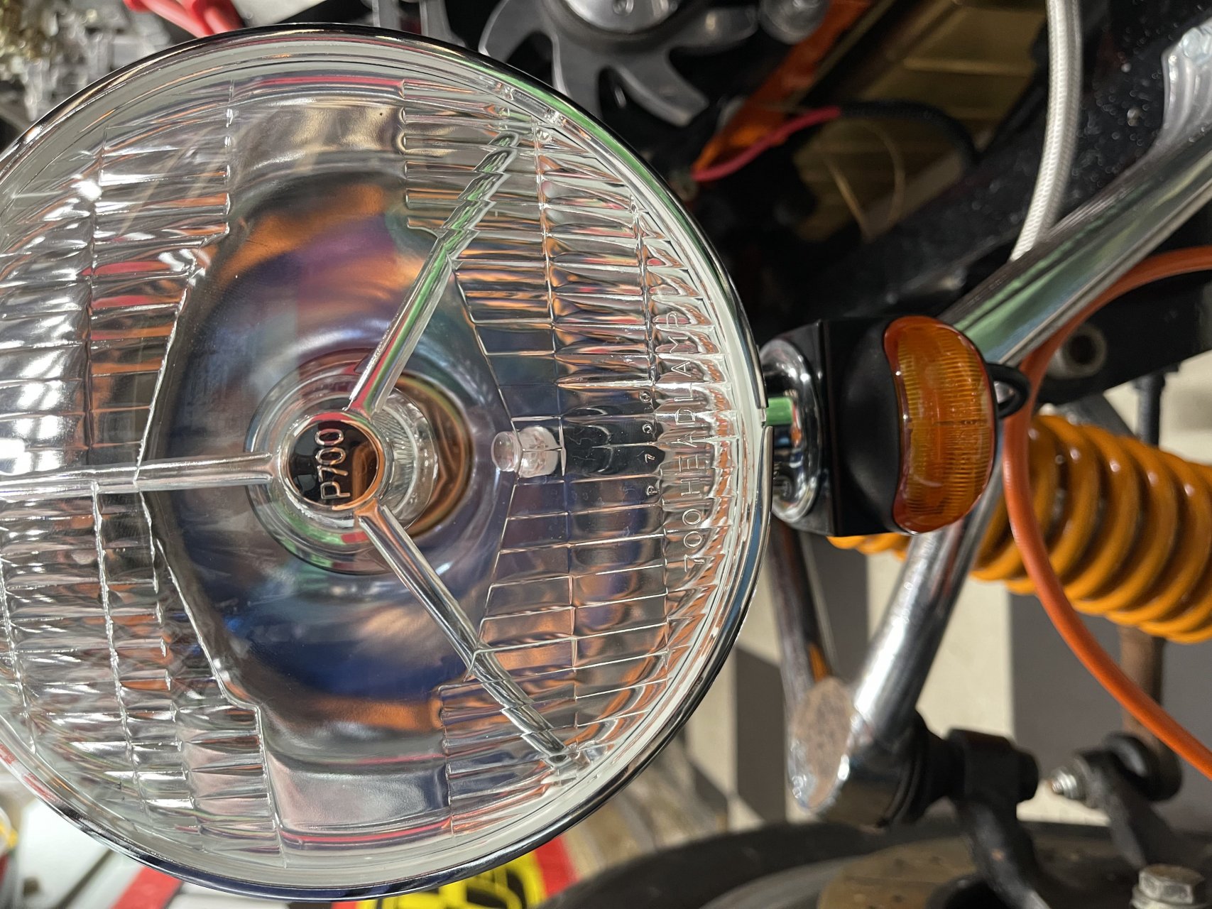

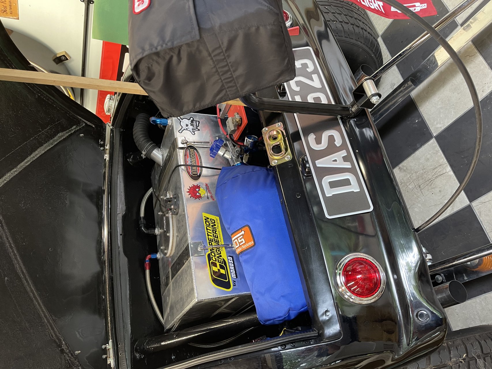

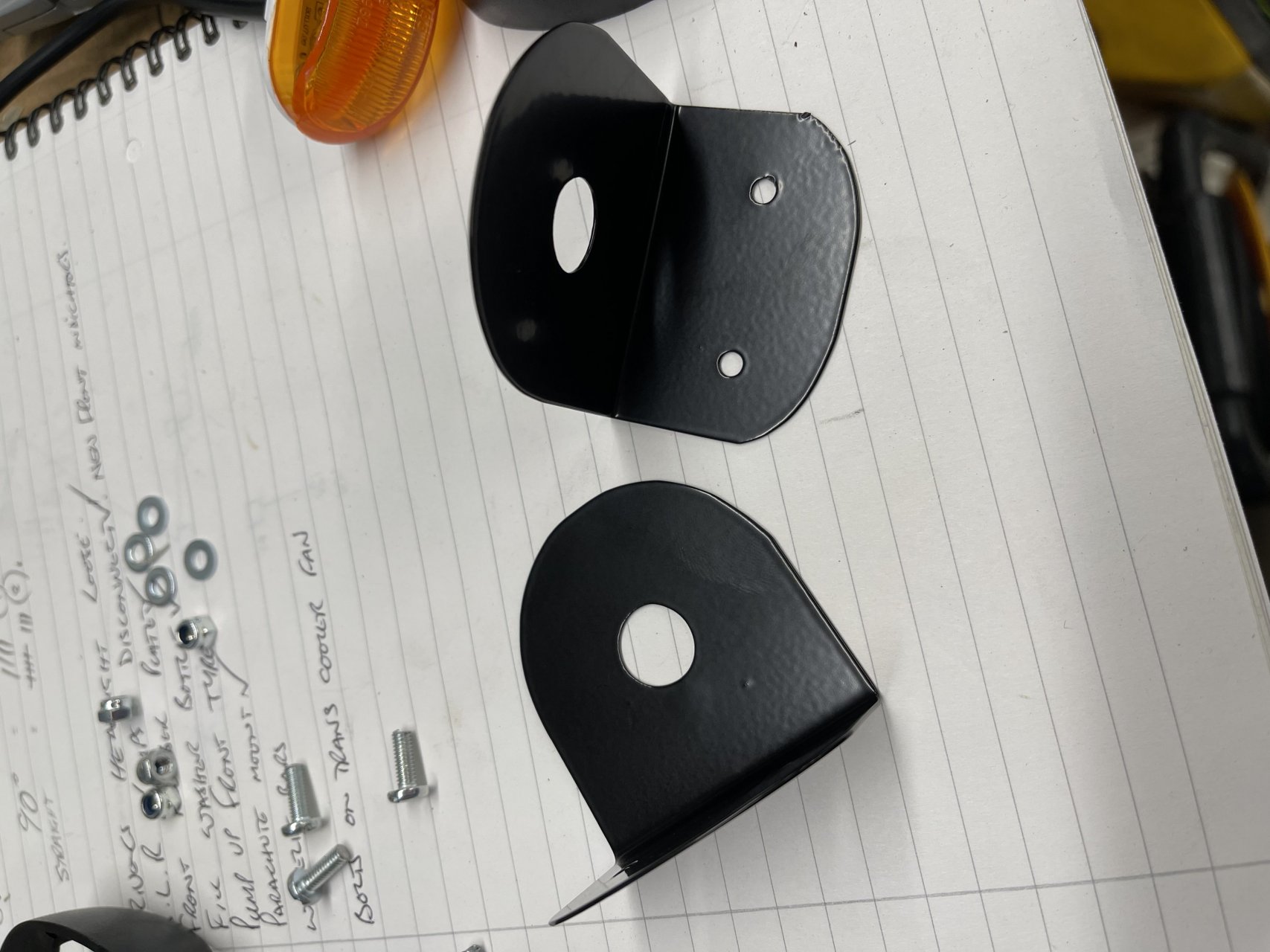

Whilst building the car I thought wouldn't it be useful to add some daylight running lights. I built a dual bracket for the DLR's and indicators.
I was happy with the way it looked, the indicators worked fine but the DLR's flicker badly, so out they come.
http://www.torquedup.co.uk/forum/ima...b9a175665a.jpg
I can't leave the bracket as is so....
Made a pair of new brackets out of some scrap steel sheet, powder coated of course.
http://www.torquedup.co.uk/forum/ima...b9a178e205.jpg
Attachment 56359
Installed under the headlight.
http://www.torquedup.co.uk/forum/ima...b9a1756219.jpg
Attachment 56360
Parachute mount sanded and in place.
http://www.torquedup.co.uk/forum/ima...b9a1786ab7.jpg
Attachment 56358
The car is now off SORN, insured and back on the road!!!
MOT booked for next Monday at 10am.

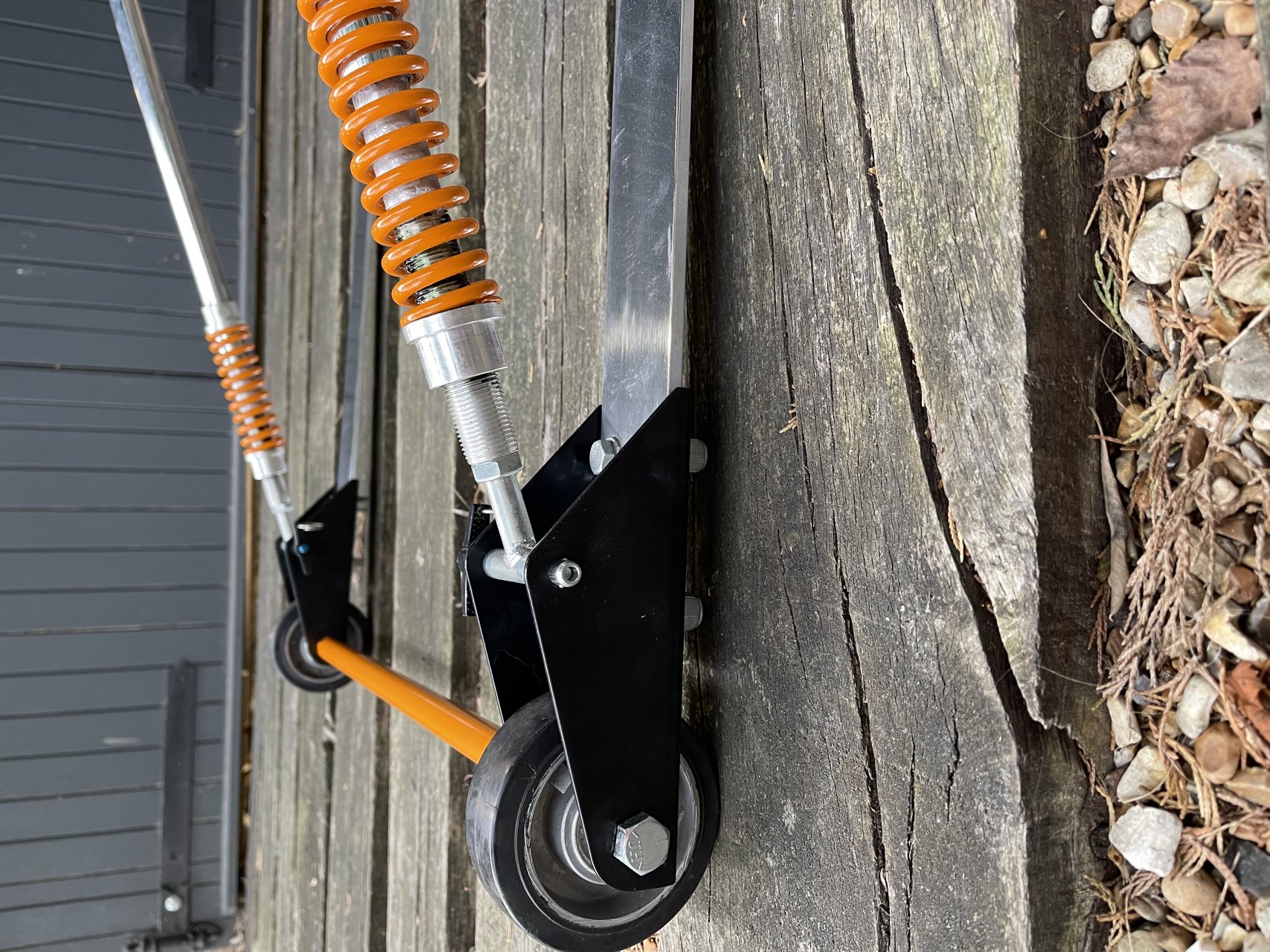

Wheelie bars in place...check.
http://www.torquedup.co.uk/forum/ima...ce7d853016.jpg
Attachment 56361

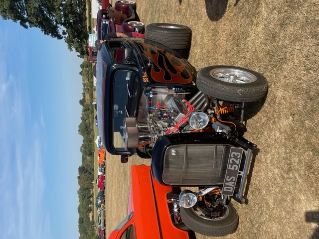

(14/08/22) Got there in the end....
Great meeting up Phil, car is looking great, and all the people I spoke to who had seen it really liked it and appreciated the work put in.
(Missing Picture)
For the people on here, proof the big man made it.
http://www.torquedup.co.uk/forum/ima...9612ebf812.jpg
Hope the ride home was uneventfulhttp://www.torquedup.co.uk/forum/images/smilies/tup.gif
(15/08/22)
Well we got there.
http://www.torquedup.co.uk/forum/ima...a4478af74f.jpg
Attachment 56346
Engine was running a little hot but the fan brought it back in range.

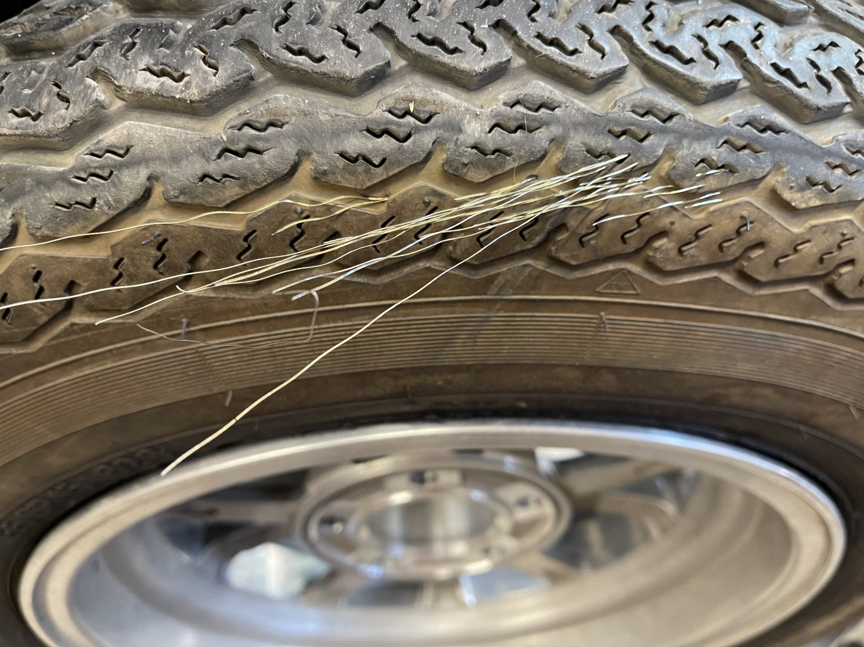

The ride home was uneventful until I got close to home when the steering wheel started shaking!
You were right about the front wheel alignment!!! 2 knackerd front tyres being the result.
I did say I needed to replace them but now its 'must' replace them.

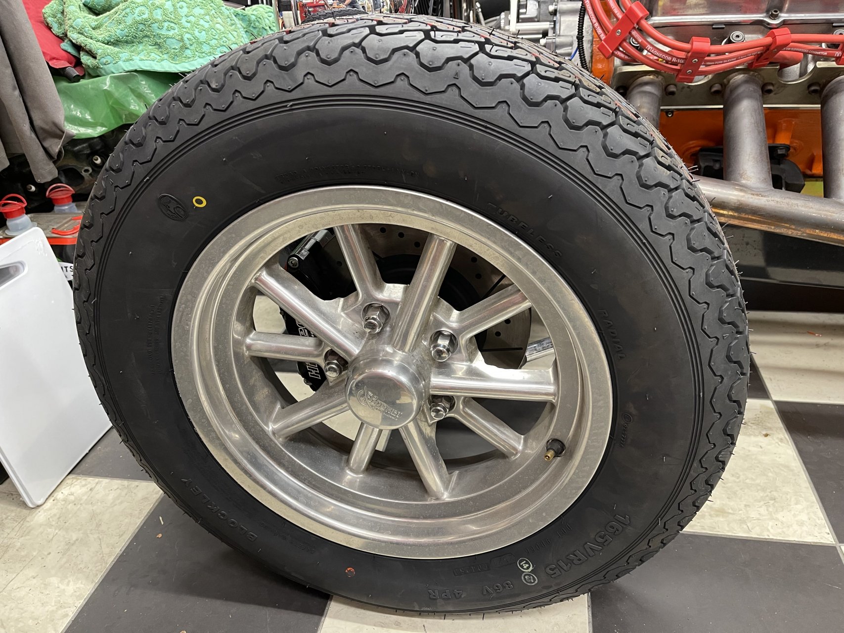

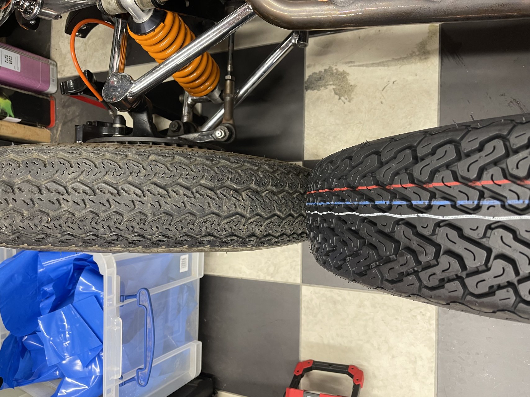

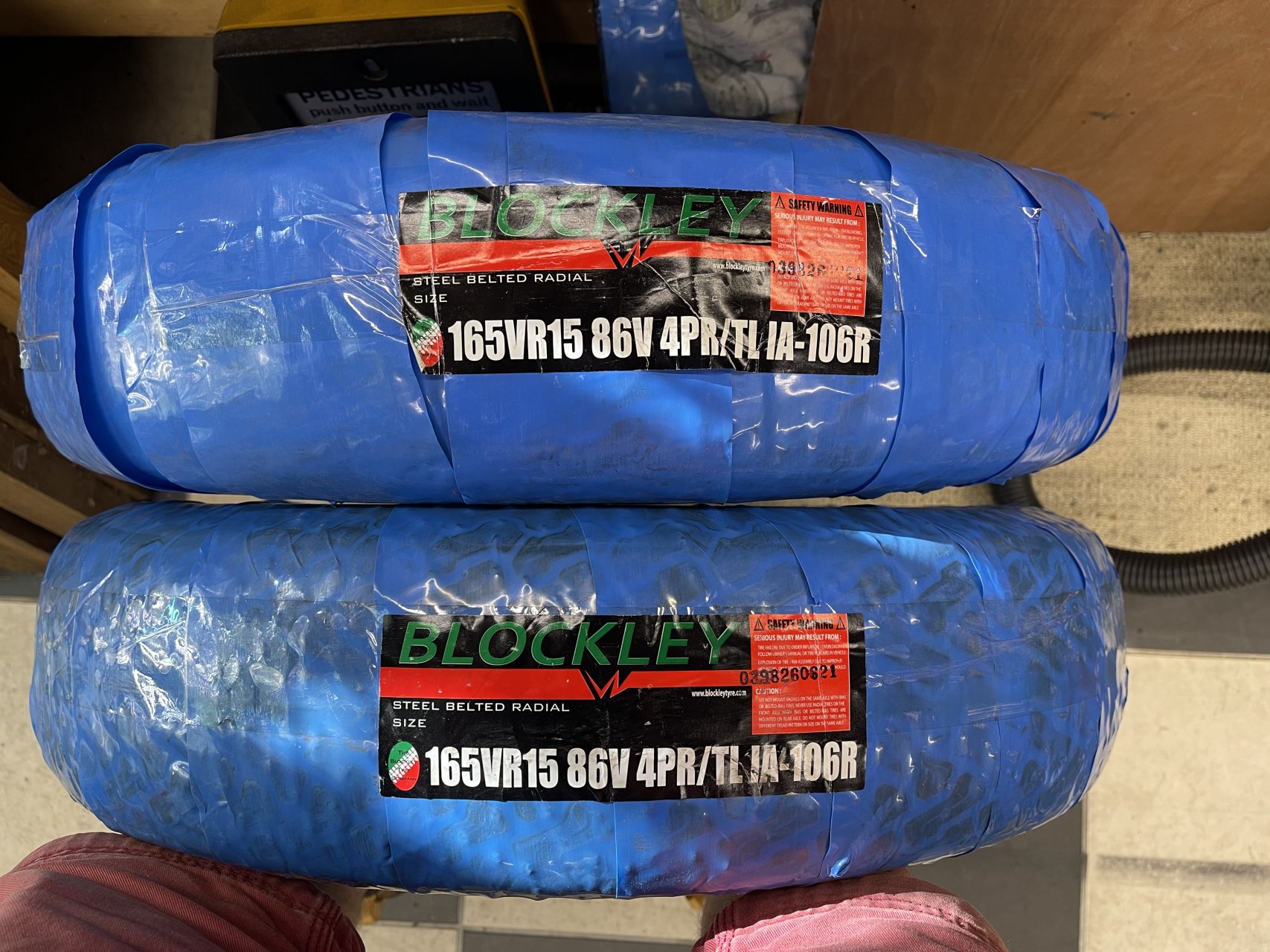

(23/08/22)

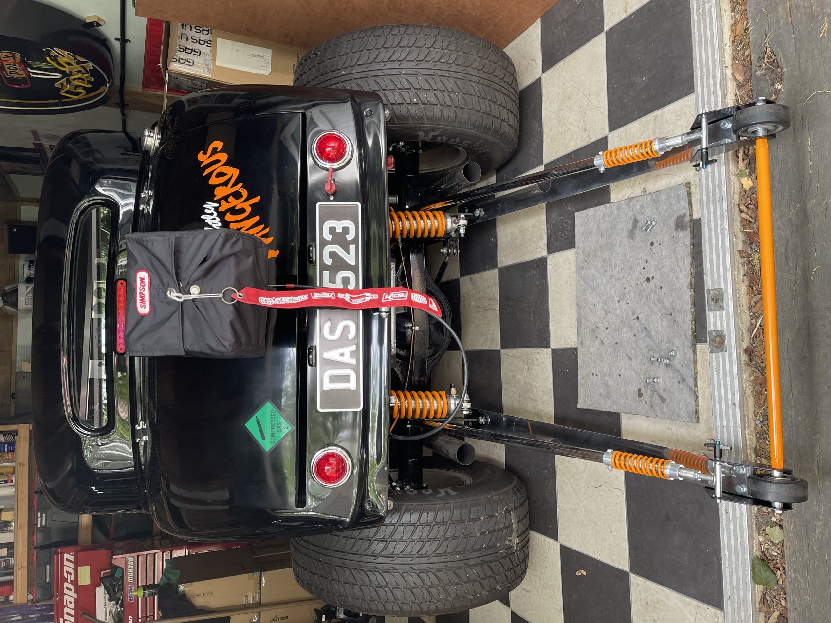

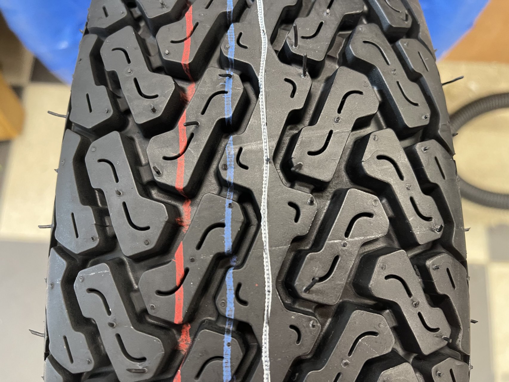

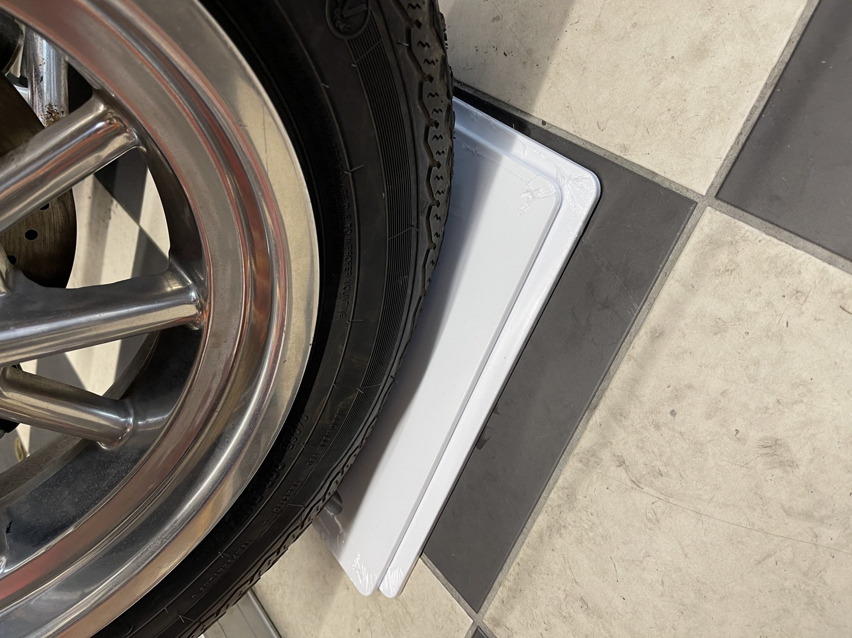

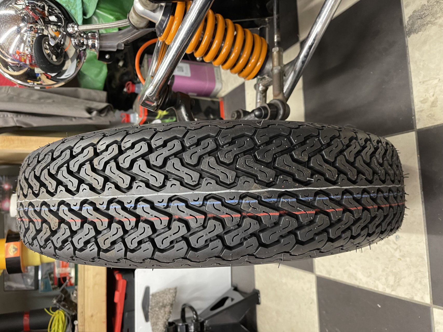

At the moment the car has 155xR15 on the front.
These are now useless as they are all scrubbed out on the outside edge.
I've found a company called Blockley Tyres who do a 165xVR15 and I am waiting for a pair to arrive.

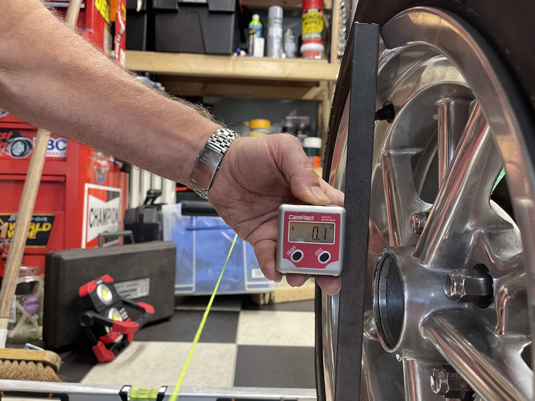

In the mean time I've set up my alignment strings. They run perfectly parallel to the hubs ignore the floor tiles its the camera angle.
http://www.torquedup.co.uk/forum/ima...4d392b0aee.jpg
http://www.torquedup.co.uk/forum/ima...4d392b0ac7.jpg
The rear wheels are in perfect alignment, which is good http://www.torquedup.co.uk/forum/images/smilies/tup.gif
The fronts however were going in different directions!!!
Once the steering wheel had been centred and held level with a couple of ratchet straps front wheel measurements were taken.

Got the strings back out and had a measure up.
I now have 1.25mm toe in each side = 2.5mm total.
The steel plates for the turntables went out the window when I found out it would cost me almost £50 for the four!!!
Plastic chopping boards came to the rescue @£2.00 each http://www.torquedup.co.uk/forum/images/smilies/tup.gif
Applied a good squirt of grease between them, worked a treat.
http://www.torquedup.co.uk/forum/ima...1e85c6d521.jpg
Attachment 56339
Quick camber check and the wheels have what equates to 1.00mm negative camber.
This needs to be a fraction more but the process means I would have to take the front suspension apart again (It can wait until winter).
http://www.torquedup.co.uk/forum/ima...1e85e88263.jpg
Attachment 56338
The new tyres in place.
http://www.torquedup.co.uk/forum/ima...1e85ce8083.jpg
Attachment 56336
http://www.torquedup.co.uk/forum/ima...1e85b64871.jpg
Attachment 56337
As they are 'Classic' tyres they have an 80% profile on the side wall which means I have gained 1/2" more clearance on the sump, result!
http://www.torquedup.co.uk/forum/ima...1e85aebaba.jpg
Attachment 56335
The guy in the garage said he had never seen a tyre poke its steel belting straight out the side wall before.
There's no wear, the steel threads have just poked through.
http://www.torquedup.co.uk/forum/ima...1e85cbc358.jpg
Attachment 56334

Then thought...while I'm down here lets have a look at the side pipes.
Attachment 56330
http://www.torquedup.co.uk/forum/ima...d80d131633.jpg
http://www.torquedup.co.uk/forum/ima...d80d130d03.jpg
Attachment 56331
http://www.torquedup.co.uk/forum/ima...d80d12d1a5.jpg
Attachment 56332
http://www.torquedup.co.uk/forum/ima...d80d13163f.jpg
Attachment 56333
Got them both mounted up on the chassis rails. Now got to get some headers made!
