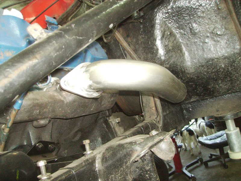

the exhaust 'u' bends arrived today so getting the exhaust started was first on the list. the flanges needed the slotted holes slotting some more inwards to line up with the manifolds. then the 'u' bends are 2 1/2" and the manifolds/flanges are 2" so after cutting the angles for each side they needed reducing by 1/2". some thin pie cuts and welding later they were welded to the flanges. we retieved the exhaust system we took off 2 1/2 years ago (it pays to be a hoarder) and ash' hung it back in place. ash' filled the rear axle with lsd additive and gear oil. after finding a long bolt the alternator was hung on the side of the engine and slid back til the pulleys all lined up and a measurement could be taken for the spacer it needs. the adjuster bracket we found here will bolt straight to a threaded boss on the water pump as if it was made for it and a short bit of flat bar will provide support for the long bolt so it's doesn't bend.
we then made 'the list' which surprisingly was only about a dozen items left to do.

we got the downpipes made today, well almost. we're waiting for a pair of 2 1/2" flanges for the driver's side, one for the downpipe and one for the system. they come as a pair with a gasket and nuts and bolts for under £11 so not bad. also the alternator brackets are made so we can measure up for a fanbelt now. 11 jobs left on the list.

the last 2 flanges arrived today so the exhaust is now done, tick. we sorted through my 'pile' of fanbelts and found a new one that fits, tick. the rocker covers, rockers, pushrods and inlets are stripped off of both engines and all the gasket faces are cleaned up on ashley's ready for new gaskets and the weiand inlet to go back on, 1/2 a tick lol.
