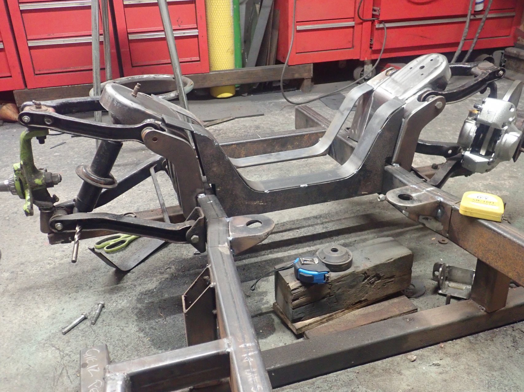

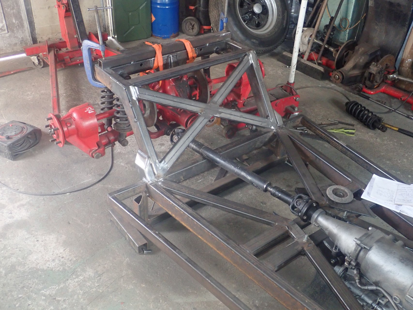

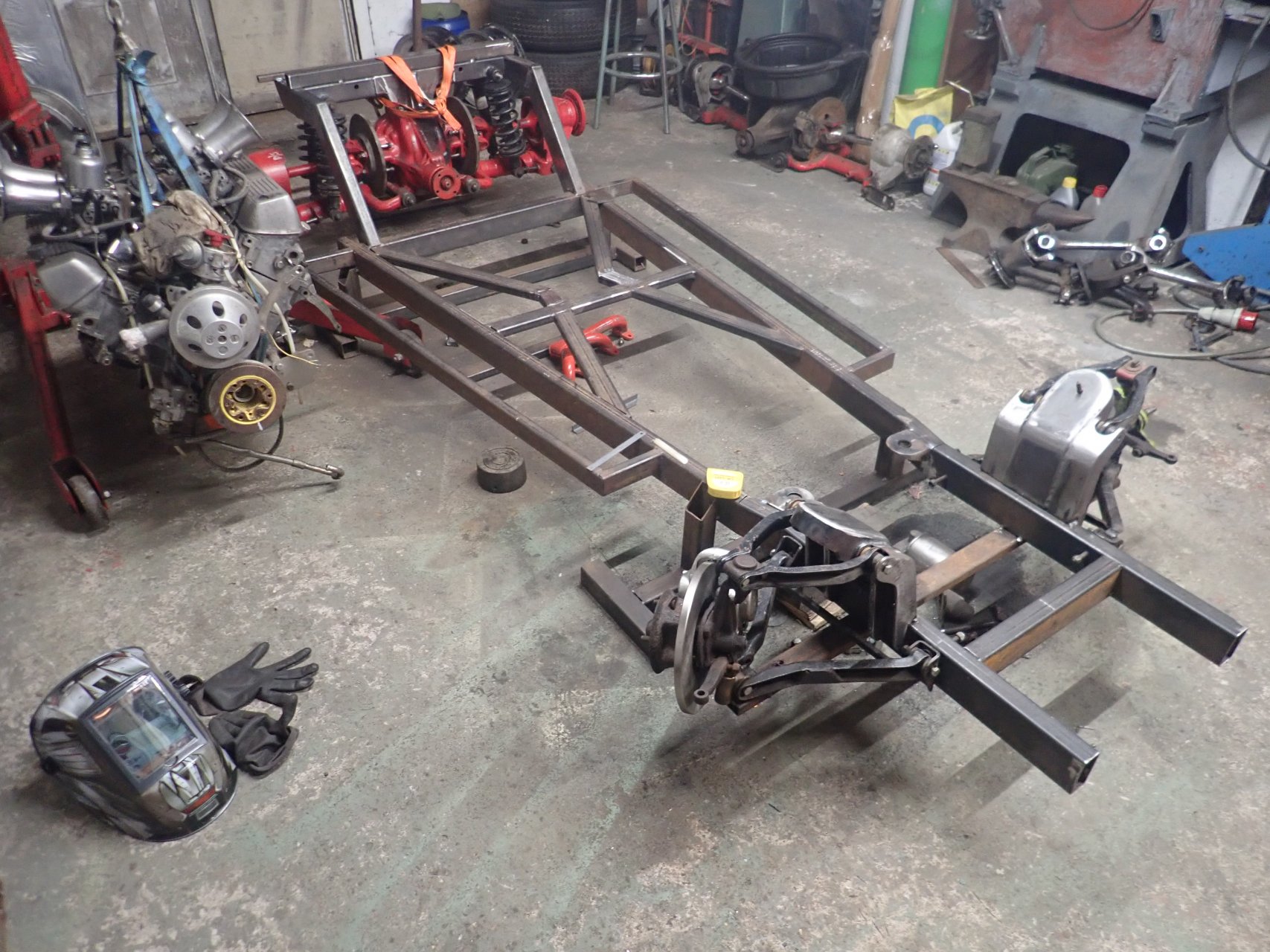

I used the Jago chassis as a sort of base / jig to set up the new frame , its all pretty basic . The front suspension is based around the Vitesse parts that were on the Jago, the subframe was scratch build on a narrowed footprint .

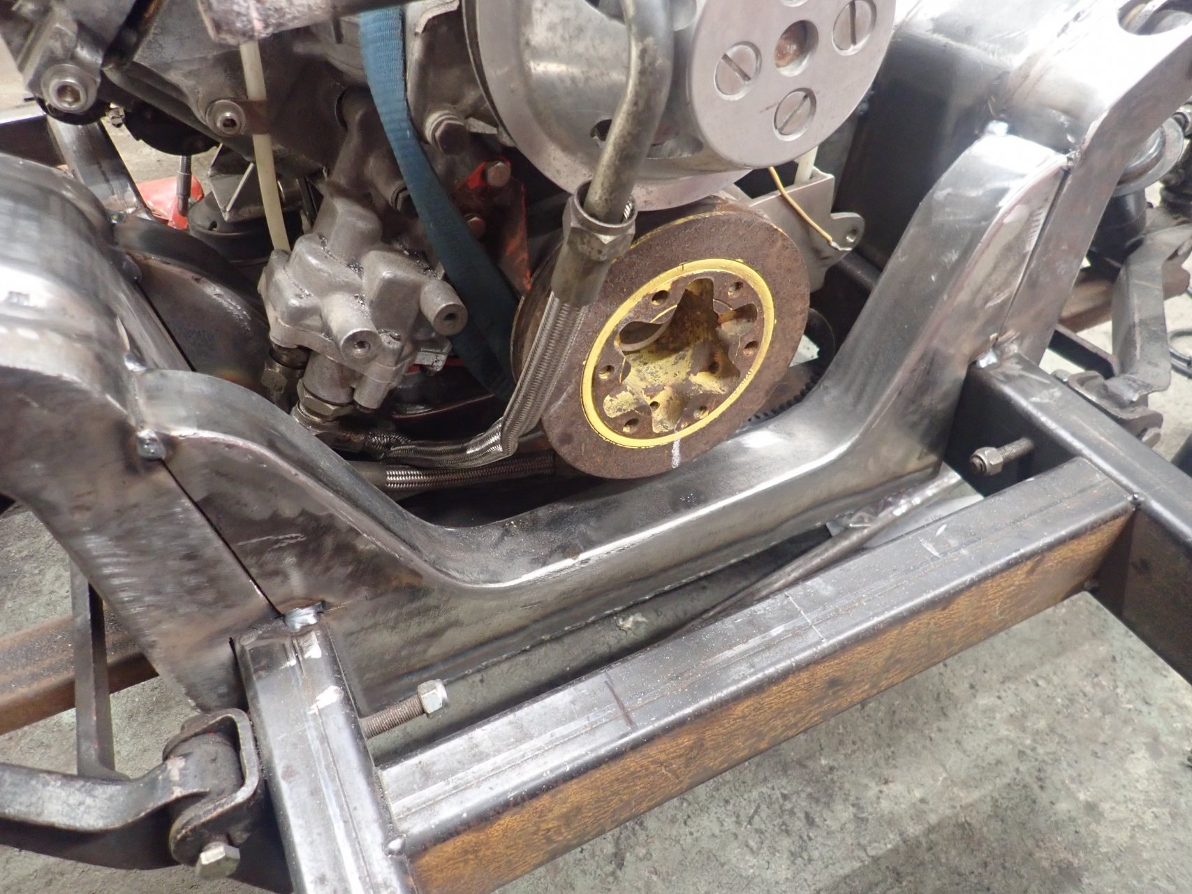

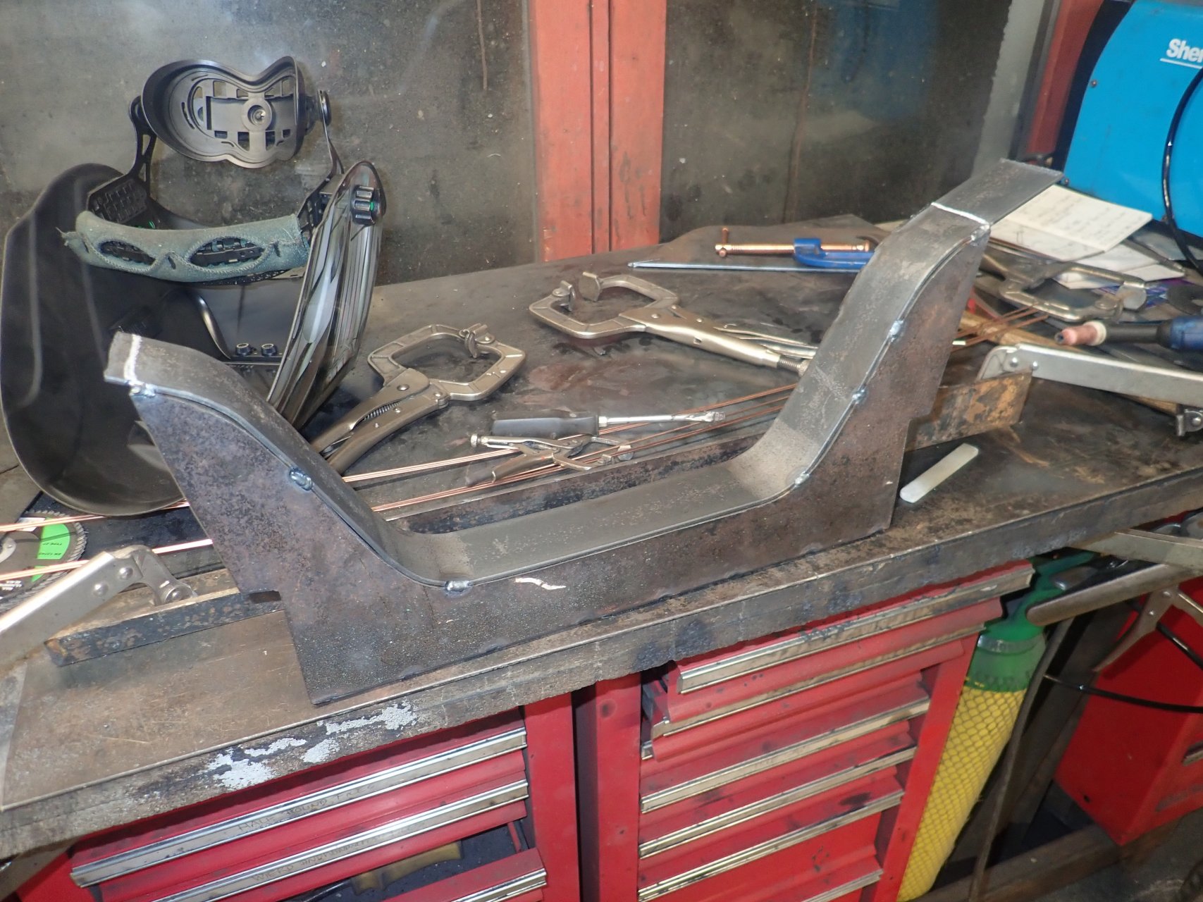

the central part of the front X member was made from flat steel . I doubled up leaving a gap between the front and rear section to allow the Rover oil punp a place to live without setting the engine either to far back or to far forward . The double X member also adds a fair bit of strength .
Attachment 65305
It might look a bit wierd but it serves a purpose .
Attachment 65306
lets the engine sit in a decent position nice and low and no issues with the pump location
Attachment 65307

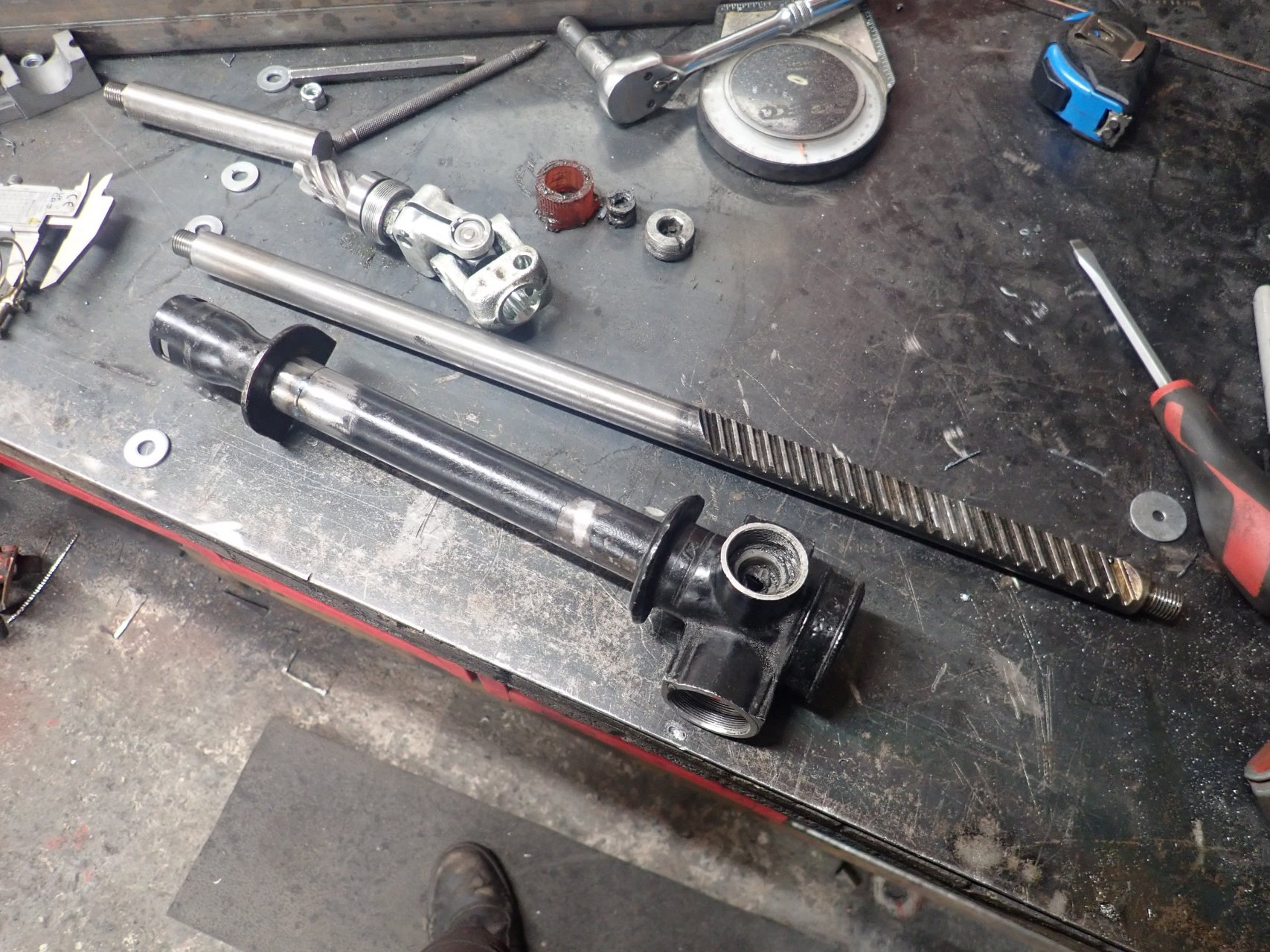

Vitesse steering rack narrowed to suit , most expensive part of this operation was the die nut , Bought a decent one as the chinese stuff seems to rip threads .
Attachment 65309

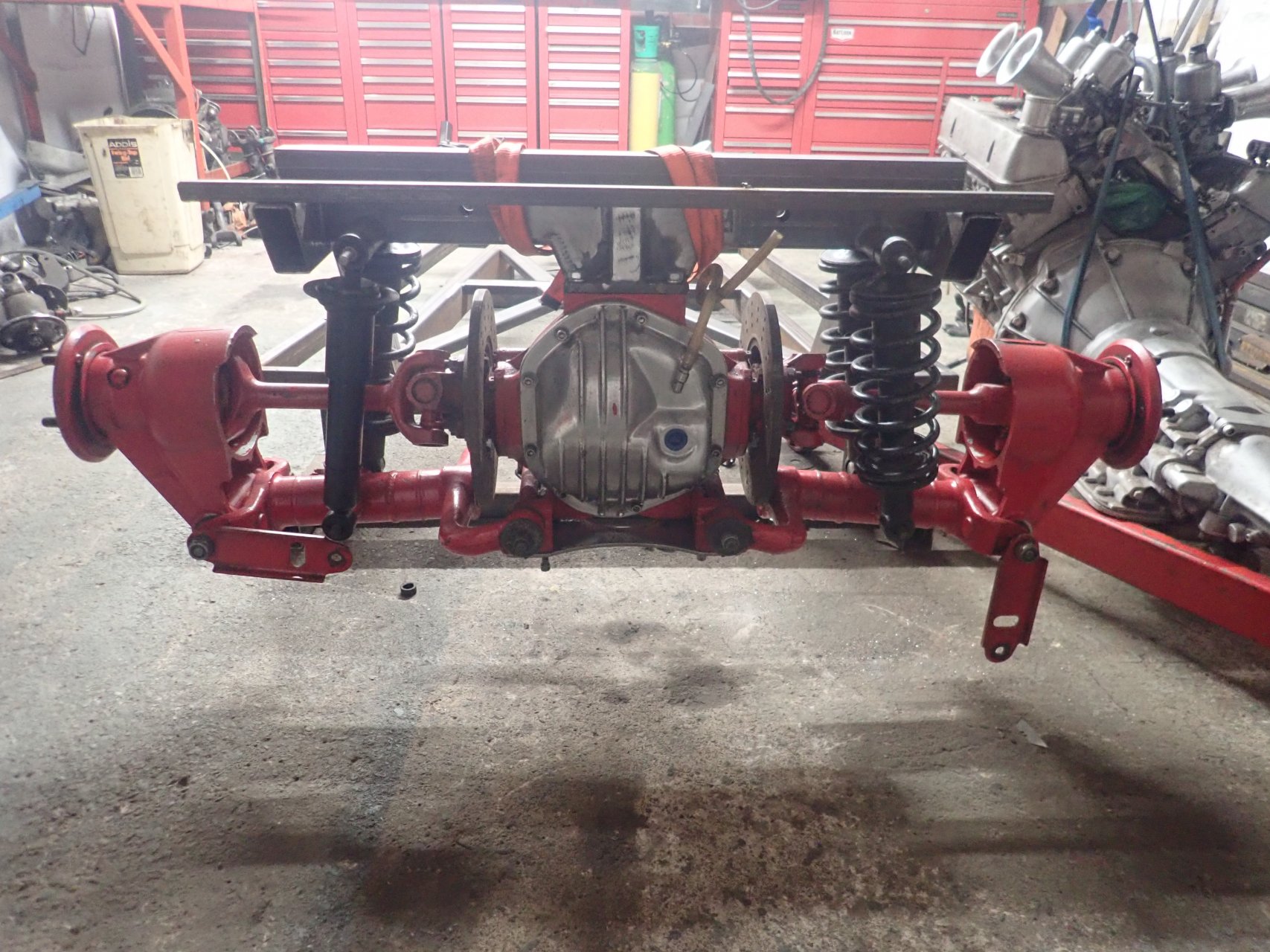

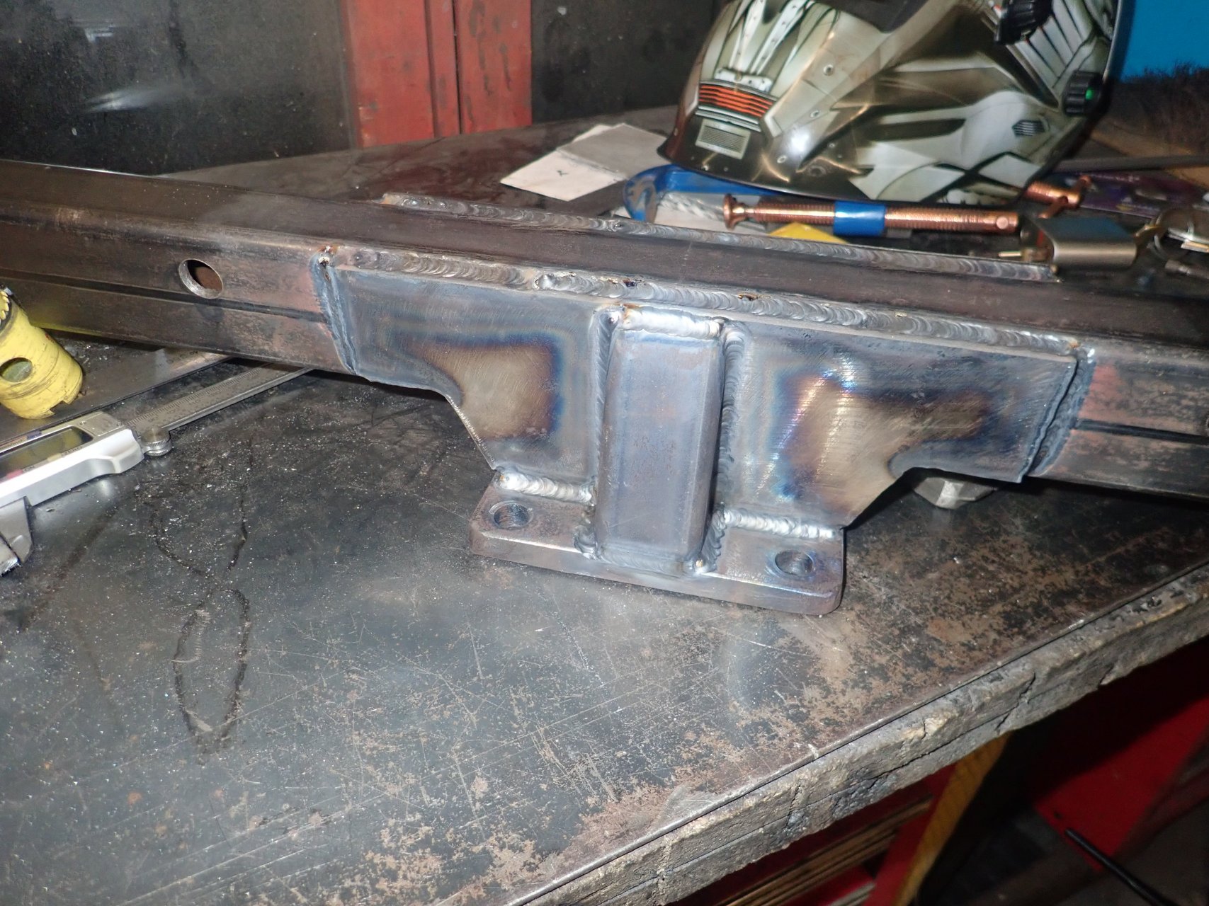

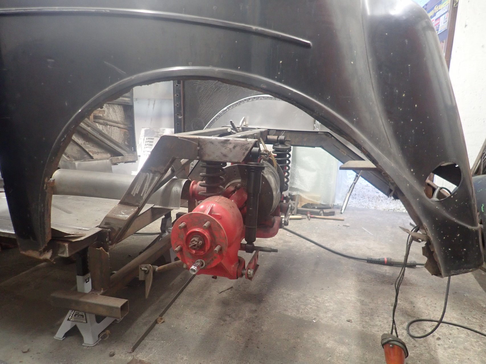

Fabricated a new rear crossmember for the Jag rear
Attachment 65304
Jag rear in the pics isnt the one that came with the chassis . I was in the process of narrowing the original when in conversation I was offered this one for ?165 . It would have been nuts to knock it back and being a budget build it was a great find and a very generous price .
Attachment 65308
It turned out that it had originally been fitted to a POP and was in the ball park width I was looking for . Its not quite as narrow as I intended but for the price and the time saved I can live with it .
Attachment 65310
