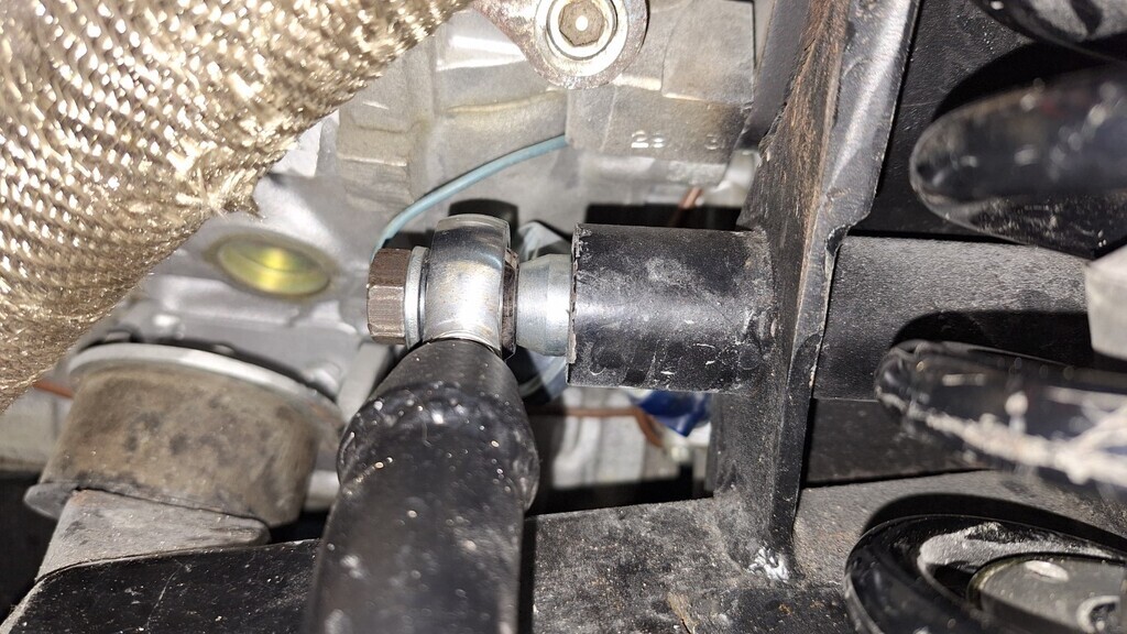

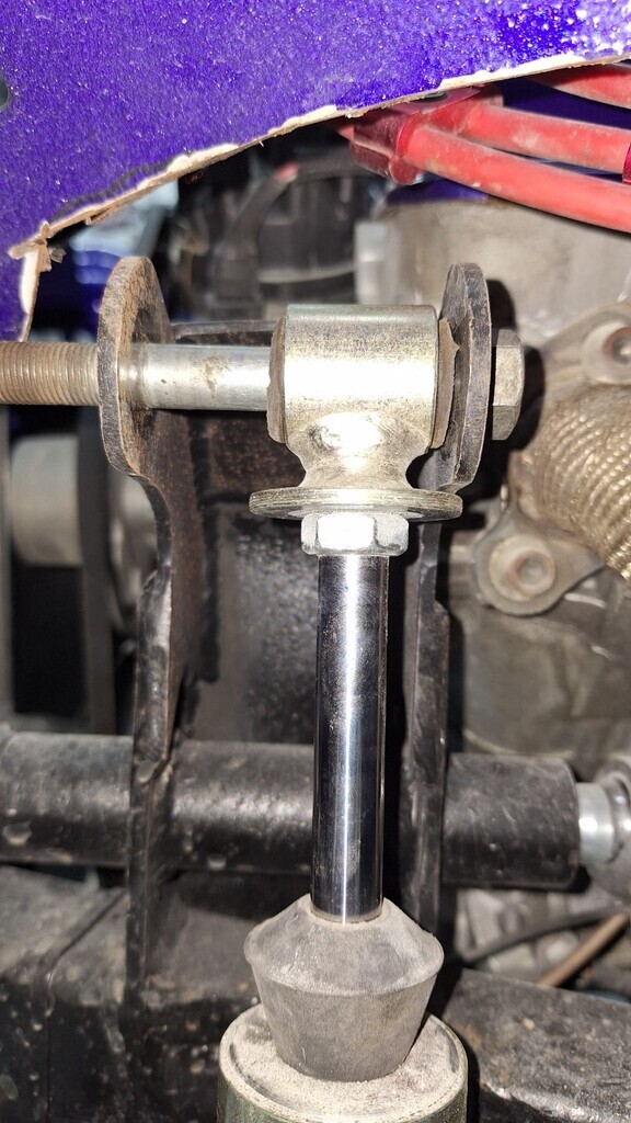

Front suspension - assembled with no locking nuts anywhere https://storage.proboards.com/forum/...ey/shocked.png
Attachment 65962
https://img.retro-rides.org/i/v/blac...6e5d8e9efa.jpg
