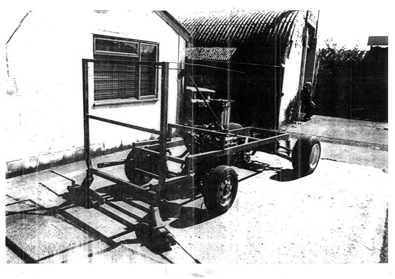

    Pic of the Truck as it was in the ‘90s.
    ~original

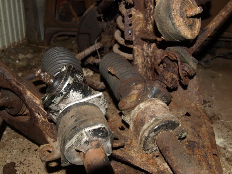

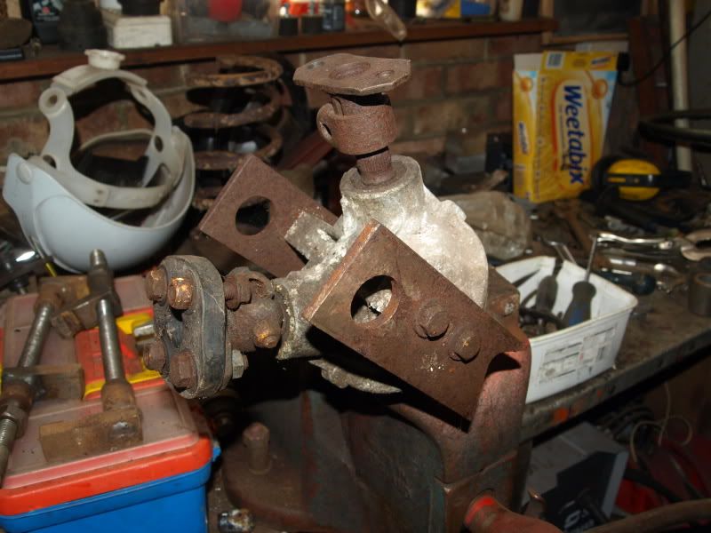

    Steering
    Front suspension is a complete Ford Cortina Mk3 clip but the hubs and brakes though are from a P100 pickup (I shall explain in a later post). Now obviously a Cortina rack points backwards but I shall be sitting above it. To sort this out the rack was stripped down, turned on a lathe to remove the 'corners' of the 'D' shape. Ally welded (Thanks to John at ARMA Rods) then re-machined to put the 'D' shape back but all at a different angle. As you can see from the pic (Modified Left, original still on a subframe Right) it now points forward towards the next trick in the box which is a VW LT van transfer box. This will be at the front of the cab and it both turns the stearing through an 'L' direction so it goes back towards the rack AND corrects the now reversed rack otherwise turning the steering wheel right would send the Truck left!!!
    The trouble with having all these parts hanging around for over a decade is they've all developed erm 'Patina'!!!!! Will look better once I've cleaned it all up and painted it.

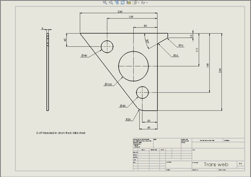

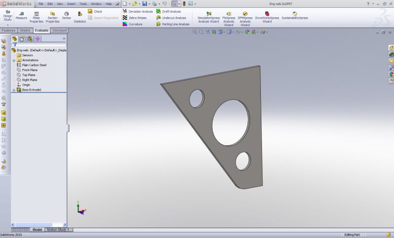

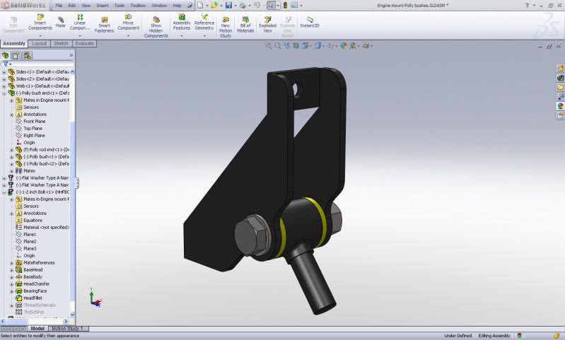

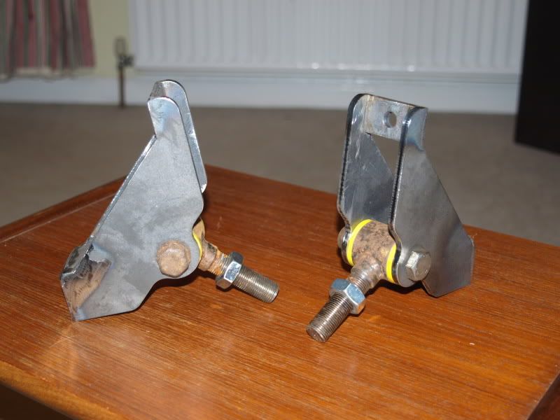

    Engine mounts.
    As my GM box came with a Polly bushed mount I decided to sort some Polly bushed engine mounts to suit. After some measuring and design work I came up with a pair of profiled plates with rectangular backing/mounting plates where they bolt to the block.
    Click on the pic
    It's an AVI file (Video). Otherwise click on the pic and it will take you to the vid....
    Still picture of one mount.

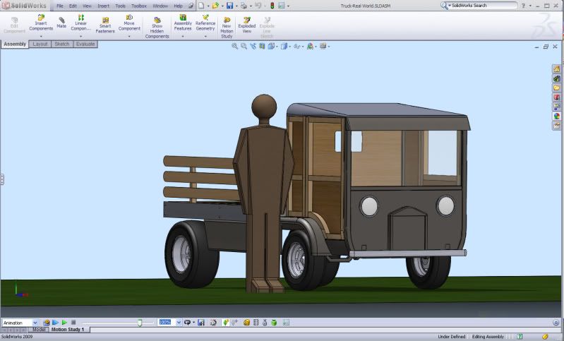

    360 View
    Ok I guess this is showing off a little, but click on the pic and you'll be able to see all around the model. NOTE: The engine & box are just a rough draught but in virtual reality weigh the same, and I haven't added the front suspension, and Jag IRS yet. Bed is set higher than before as the SVA rules sate I can't have anything in the bed area, so it's now above the engine. Looks more original there I think.
