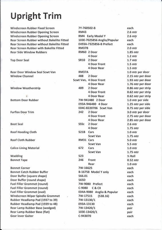

    Where might I purchase a boot seal? Repairs are progressing nicely. Thanks, Jay

    These stock Anglia/Pop boot rubbers, both here in the UK Jay. It`s good to hear your car is on the mend!...
    https://www.smallfordspares.co.uk/
    http://www.thepopshop.org.uk/Pages/Interior%20page.htm

    Thanks for the links. Small Ford Spares lists several sizes. Any idea why or which would be the correct one to order?

    Hi Jay,I only see two listed both 'SSSc' but different lengths, the short length Is for the four door as has a smaller boot.
    i didn't buy mine from there ,that was back in 1979 ,but I could measure the section on my car for you,the seal is nothing special,you may be able to source it over there.

    The above sizes are too thin Jay,you need around 10mm thick when fixing the seal to the boot lid,maybe less than 10mm if you have a steel boot lid.
    I was looking at this listing on the small ford spare site.
    click on the illustration of the Anglia or the Popular ,then click on 'upholstery and trimmings ' folder.
    See 'Boot Seal' i expect it is the correct size and very soft sponge.
