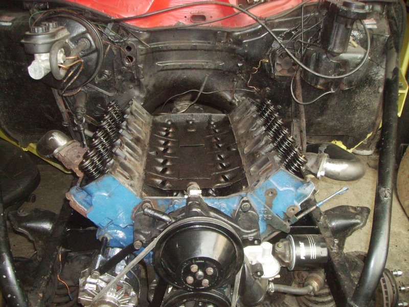

    the new rear tyres are fitted to the 10x15 rear slot mags and the front tyres now have leak free beads for a pump free future. we worked out where the chrome gm type alternator will go and how the brackets will be made. the new braided stainless rear brake flexi is fitted meaning once the 3 way arrives and is fitted along with tabs for the caliper flexis and hard line p clips we can bleed the brakes. while waiting for bits we can swap the inlet manifold and rocker covers (the bling) and prime the oil pressure before plopping in the new distributor. we have the ngk coil and plug leads to go on too. wiring will be soon, we have an american ford type solenoid ready to fit and we'll have to work out what wires do what as it was over 2 years ago we took it apart and of course labelled all the wires..... not. ash' said they're breaking one of the works transits so he'll nab the propshaft for it's sliding section and we still have to sort a front bit with uj to fit the truck c6 rear flange, although we did sort a pair of the 'flat' u bolts the right size.

    after flipping the weiand inlet over today we realised it's one of those small runner inlets for 'economy'. except it's not really as the small ports only go about 2 1/2" in then there's a rounded step up to the full runner size. so we cleaned the gasket faces and drew the gasket port size on it. bl00dy hell, the head/gasket ports are just over 1/2" taller and 1/4" wider. also the ports squeeze in about 3/4" in where the pushrods go through the inlet casting. after checking there's loads of 'meat' there so 2 hours later the ports are full size which must increase power by about 30hp without the extra it being a 'performance' inlet to start with. definately worth the effort. here's some pics today including ports before (showing the sharpie line where the gasket is) and after porting. oh, and a few coats of silver wheels and it'll be easier to keep 'nice'.
